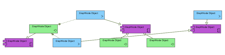

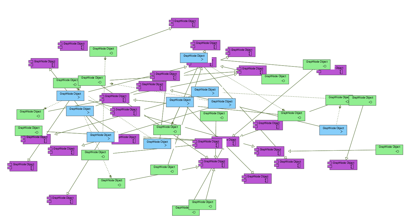

SpringLayout
• Node overlapping
• Edge crossing
• Nodes are randomly drawn on the canvas. And tied together by using a force related layout. The canvas space is used properly but several node overlappings and crossings.
index.php/fa/23955/0/

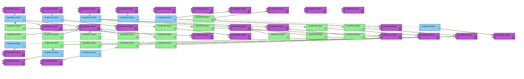

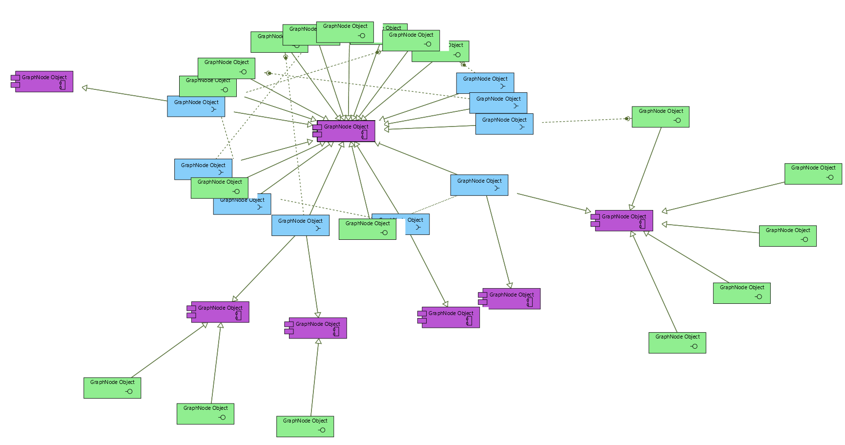

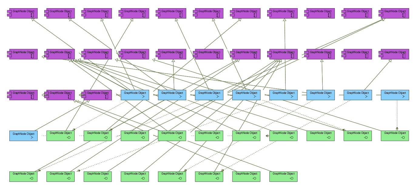

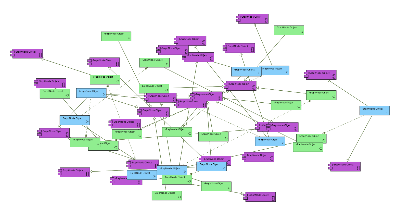

Re: [Zest] Layout implementations and node overlapping [message #1715581 is a reply to message #1715152] Tue, 24 November 2015 08:14 Go to previous messageGo to next message
Thanks that helped.
Now the SugiyamaAlgorithm is working.
index.php/fa/24064/0/
But I am not satisfied with the result of the Algorithms.
The graph is planar. This is not taken into account in the algorithms, since every layout has some crossings. For instance the Springlayout has a lot of crossings and node overlappings. As seen in:
index.php/fa/24065/0/.

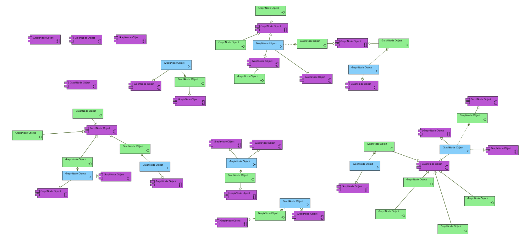

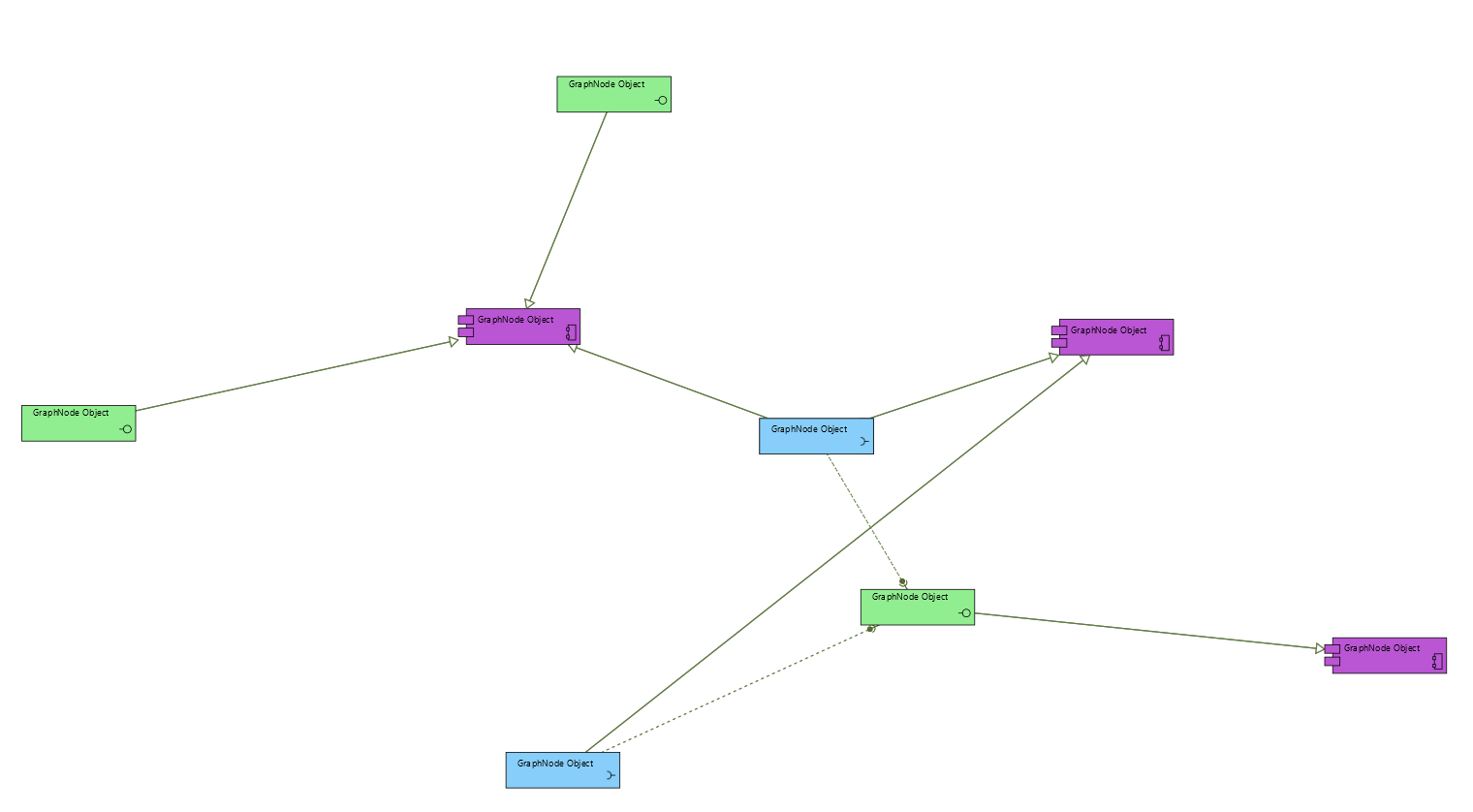

Re: [Zest] Layout implementations and node overlapping [message #1717741 is a reply to message #1717713] Wed, 16 December 2015 07:56 Go to previous messageGo to next message
To show some deficits of the layouts. I've used a simple, planar, directed and connected graph as an example.
Tree
index.php/fa/24342/0/
Spring
index.php/fa/24343/0/
Sugiyama
index.php/fa/24344/0/
Radial
index.php/fa/24345/0/
as you can see, all layouts except the sugiyama layout do have edge crossings for this instance.
