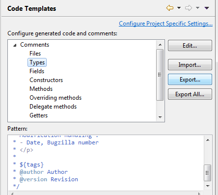

Thanh Liem PHAN is currently offline Thanh Liem PHANFriend
Messages: 8
Registered: November 2015
Of course, if I use "Author" only, it's ok.
index.php/fa/23858/0/
Then I tried with both $Author$, and $$Author$$. They don't work.
The comment showed in the eclipse target platform is always the default one.
index.php/fa/23859/0/
It seems that if oomph detect an error or a problem in the <template>...</template>, it will replace by the default one.
