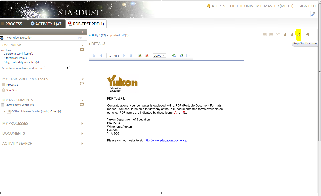

Hi Ajay,
When you open the attached document in process , you can see a option "Popout Document" which opens the document in a new window.
index.php/fa/23804/0/
Hope this serves your purpose.
