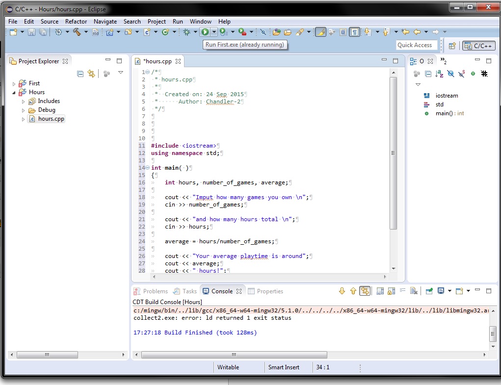

When running eclipse I'm not able to run C++ programs after the first initial one. It seems like I'm able to build it correctly, but when it comes to running it, eclipse just seems to want to run other programs. In the picture I highlighted that I could only run 'First' and wasn't able to run "Hours' despite me working on "Hours'. Any help?

The Run and Debug toolbar buttons default to running the last program you most recently launched. If you look at the toolbar button closely, you'll notice that it has a drop-down arrow next to it, which can be clicked to see a list of recently run programs.
You can also change the default behavior so that clicking the button launches a program that is associated with the active editor. See Preferences > Run/Debug > Launching and choose the option "Launch the selected resource or active editor" option near the bottom.

Have a look at the 'Problems' page in the bottom window. You do not have an executable file to run due to compilation errors.
