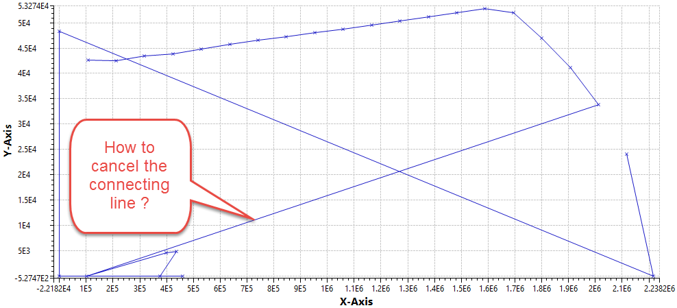

Hallo,
I am using Eclipse Nebula XYGraph for a Scientific Project.
In my next graph I will need to display data points only and not the connecting line.
index.php/fa/23287/0/
I tried setting the line width to zero (0), but this is not working.
trace.setLineWidth(0);
Any suggestion ?

  • Attachment: scr.png
    (Size: 47.72KB, Downloaded 1036 times)

This should work:
trace.setTraceType(TraceType.POINT);
Re: XYGraph - how to draw data points with no connecting line? [message #1708833 is a reply to message #1708676] Mon, 21 September 2015 11:40 Go to previous message
Max,
It works. Thank you very much!
Kind Regards
