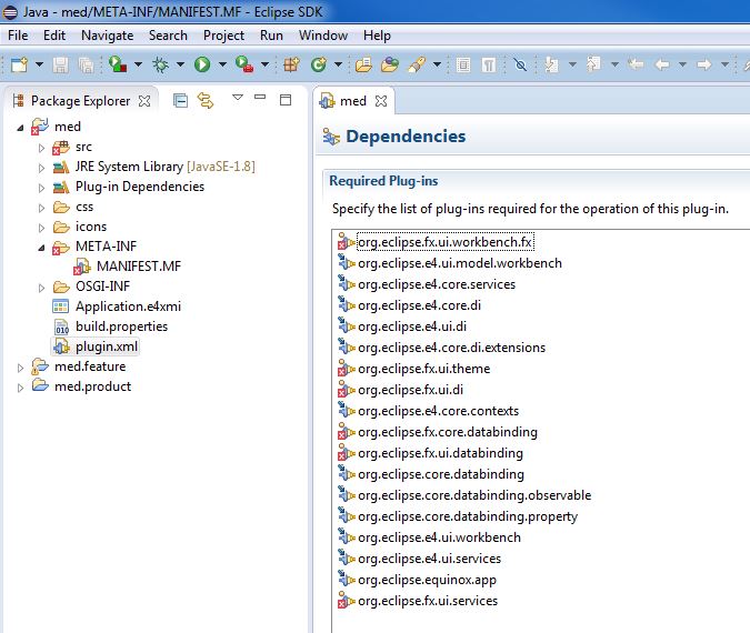

I simply created a new "e4 Media Application" sample project
(New ->> JavaFX ->> Samples ->> e4 Media Application).

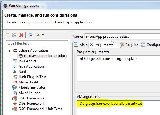

- the launch config contains the necessary "org.osgi.framework.bundle.parent=ext" definition (launchConfiguration.jpg)

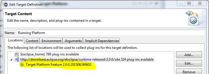

- the target platform contains the necessary "Target Platform Feature" (targetPlatform.jpg)

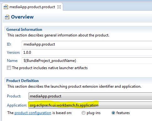

- the product definition is set to "org.eclipse.fx.ui.workbench.fx.application" (productDefinition.jpg)
- there are apparently no "SWT"-dependencies (as far as I can see...)
Moreover, all settings described are unmodified (i.e. they are exactly as created initially by "New ->> e4 Media Application").

Your target platform setup is simply wrong - you should not have the
eclipse install into your target!
Tom
On 12.08.15 11:28, Michael Marton wrote:
> Hi
> Thanks for the quick reply.
> I did not mean to port an SWT app to JavaFX.
> I do have an own e4 JavaFX project (no SWT), which also runs with e(fx)clipse 1.2 without problems but throws the same error
> with 2.0 (thats why I initially wanted to see if the provided e4 Media Application sample project works under 2.0)
> thanks
Re: Cannot run Media Application sample under e(fx)clipse 2.0 [message #1705255 is a reply to message #1705237] Thu, 13 August 2015 10:33 Go to previous messageGo to next message
Thomas Schindl is currently offline Thomas SchindlFriend
Messages: 6651
Registered: July 2009
Senior Member
I don't think so - to me it looks like your target setup in the previous
post is simply wrong and if the Eclipse install in your target you have
a big problem because then you eg have multiple javax.annotation
provides, multiple javax.xml providers, ... and things start to blow up
as you've seen it happening.
Tom
On 13.08.15 09:59, Michael Marton wrote:
> FYI:
> I checked out a fresh "RCP" version of eclipse mars, installed the
> tooling and adapted the runtime accordingly (as I did with the luna
> versions before) and everything works out-of-the-box.
> I suppose the problems I faced have to do with the provided e(fx)clipse
> "all-in-one-build", somehow.
> best regards
> Michael
Re: Cannot run Media Application sample under e(fx)clipse 2.0 [message #1705265 is a reply to message #1705255] Thu, 13 August 2015 11:25 Go to previous messageGo to next message
Michael Marton is currently offline Michael MartonFriend
Messages: 7
Registered: August 2015
Junior Member
It was also my first idea that something with the target platform is wrong.
If I use the original "all-in-one" eclipse distro and create a new "e4 sample media" project (without doing any changes to the project/workspace settings), some dependencies are missing (missingDependencies.jpg).
Thats why I extended the contained "Running Platform" target with the runtime bundles from http://download.eclipse.org/efxclipse/runtime-released/2.0.0/site.
It could well be that this was the problem.
Michael
Re: Cannot run Media Application sample under e(fx)clipse 2.0 [message #1705275 is a reply to message #1705265] Thu, 13 August 2015 12:05 Go to previous messageGo to next message
Messages: 6651
Senior Member
You never extend the running platform! You create a new empty one and
only add the e(fx)clipse target feature!
Tom
On 13.08.15 13:25, Michael Marton wrote:
> Hi
> Michael
Re: Cannot run Media Application sample under e(fx)clipse 2.0 [message #1705278 is a reply to message #1705275] Thu, 13 August 2015 12:22 Go to previous message
Messages: 7
Junior Member
Ok, now things get clearer. That might have been my fault then.
In the previous e(fx)clipse versions I always used to install the runtime and
tooling by myself (creating a separate Target, as you mentioned).
This time I thought I'll go with the "all-in-one" package to give it a quick try
(thinking that "all-in-one" means the runtime bundles are already present...).
thanks for the support
Michael
