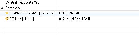

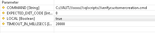

I would like to know how i can pass the value stored in Jubula to %XXXX% on the script. I noticed that by default it's not working. even though i have setlocal at the beginning of my script.
index.php/fa/22366/0/
index.php/fa/22367/0/

Can't you just append a space followed by "$CUST_NAME" (without quotes) to the end of the COMMAND parameter?
