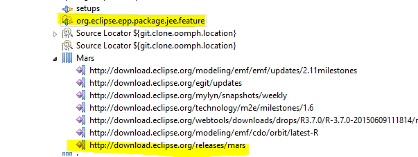

I have a project, where i depend on the feature "org.eclipse.epp.package.jee.feature.feature.group" from the repository "http://download.eclipse.org/releases/mars".
During execution of the Targlets task, I get exceptions like
ERROR: org.eclipse.equinox.p2.engine code=4 An error occurred while installing the items

It can be reproduced, when you add the requirement and repository to the Oomph project setup file.
index.php/fa/22341/0/
This happens also for other epp package features.

The error still happens with all epp package features. If I add the features of an epp package directly (and miss the product defining feature of it), it is working.
The problem must have something to do with that exact feature, plugins of that feature or p2 configuration. I think EPP has some p2.inf files to modify the content.xml further.
