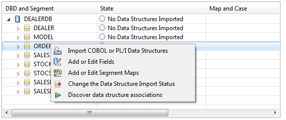

UPDATE:
Below is a picture to better describe my problem
index.php/fa/21630/0/
My issue is that regardless of what functions I call, the only context menu it reads is a different context menu that only applies to the top level
The only way I can get the correct context menu to click the item I need is by manually right clicking that segment when it begins it's search of the item
tree = bot.tree(2);
SWTBotTreeItem[] dbdtrees = tree.getAllItems();
tree.expandNode(dbdName);
dbdtrees[0].getNode("ORDER").contextMenu("Import COBOL or PL/I Data Structures").click();
The above code works without error, however, it selects and click's the ORDER segment but choses the "Import ..." menu from the base DEALERDBD file (I can check because the wizard would have different settings on start). Both the top level dbd and child level segments contain "Import ..." as one of their menus however the top level does not contain "Add or Edit Fields" while the lower does contain it as shown in picture above.
If I attempt to change it to
dbdtrees[0].getNode("ORDER").contextMenu("Add or Edit Fields").click();
Then the program freezes at that stage and gives an error of widget not found. However if I chose to right click that segment myself when it searches for the menu, it finds and clicks the correct item and opens the correct wizard
I would really appreciate any help and need to get this resolved ASAP

The problem is that regardless of what functions I call, the context menu that gets called is only the one created by the top level "DEALERDB".
For example, both top level and lower level contain "Import COBOL or PL/I Data Structures" in their menus, which works when I call them however it only opens the wizard from the "DEALERDB" level (which I can check in the settings of the wizard)
If I attempt to call any other menu item that is not in the DEALERDB but is in the ORDER row, such as "Add or Edit Fields", it gives me a widget not found error
This is a sample of the code I have been trying to test
Each of these lines gives Widget not found error however if I change the contextMenu parameter to any menu located in the "DEALERDB" it works with no errors
