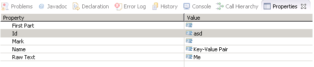

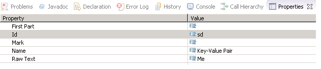

  • Attachment: left.png
    (Size: 7.24KB, Downloaded 306 times)
  • Attachment: right.png
    (Size: 6.31KB, Downloaded 294 times)
  • Attachment: model.png
    (Size: 3.22KB, Downloaded 298 times)

Also as you can see, diff points the paragraph named Summary. But, the difference is in Key-Value Paragraph. I thing it ignores the ID but I do not know where ADD and DELETE come from. When I don't use the feature filtering, the CHANGE diff comes up like below:
d.getKind(): CHANGE
d.getMatch(): MatchSpec{left=Paragraph@536dbea0 Key-Value Pair, right=Paragraph@47c81abf Key-Value Pair, origin=<null>, #differences=1, #submatches=0}
State: UNRESOLVED
diff points the paragraph named Key-Value Paragraph.
