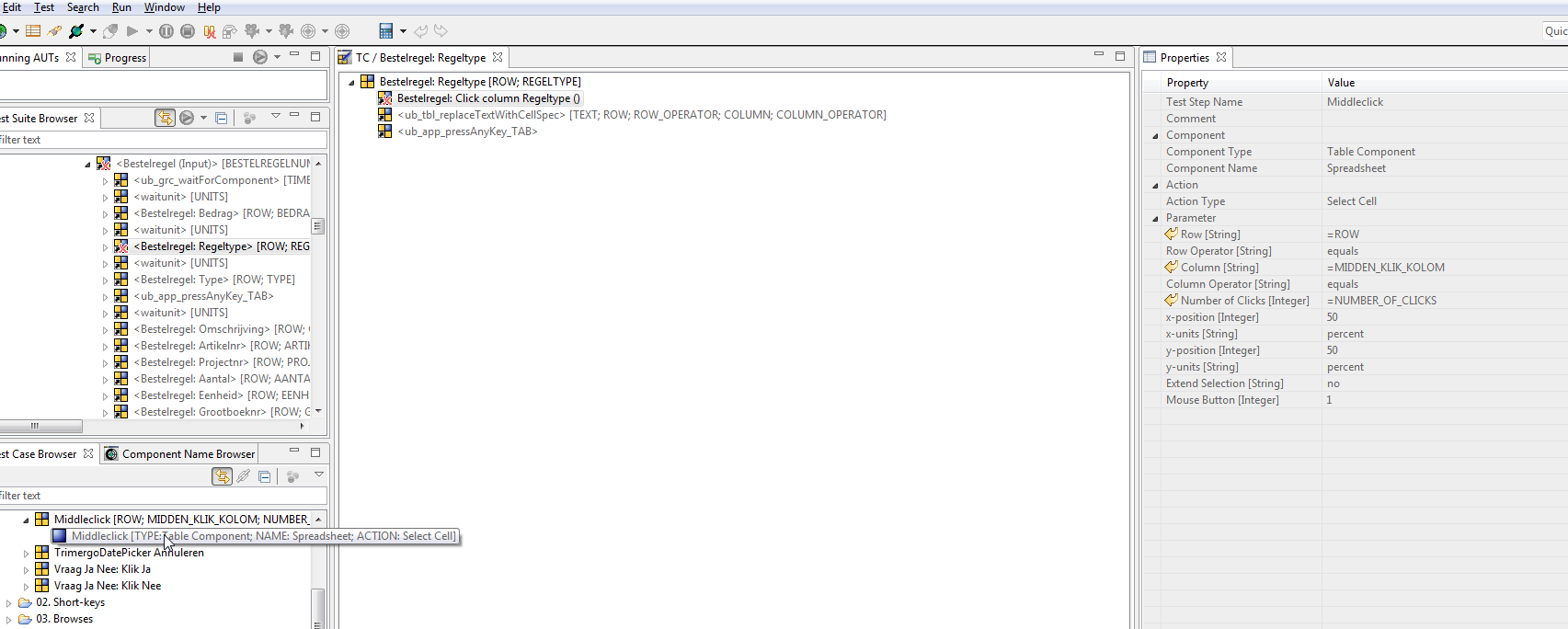

In my project I have a 'middleclick' test action wich is used in many test actions. This 'middleclick' clicks in the middle of a table column.
But now I make a copy of this Jubula Project. This 'middleclick' action is perfectly copied, but many actions using this 'middleclick' action are broken. I have to add the 'middleclick' action again.
What am i doing wrong and what can i doe to prevent this in the future?
I added a screenshot which shows de copied 'middleclick' action and a broken test action: Only the Test Case Reference Name is left, the middleclick action is missing.
many thanks in advance,
kind regards,
Jurjen
Re: Menu Test-Save As does not create a complete copy [message #1690256 is a reply to message #1690146] Thu, 26 March 2015 03:45 Go to previous messageGo to next message
Hi Jurjen,
Can you provide the two projects and any dependent projects (unbound modules etc) as a zip file on a ticket? That will help us to look at the problem.
Can you also specify in the ticket which Jubula version you are using?
Alex
