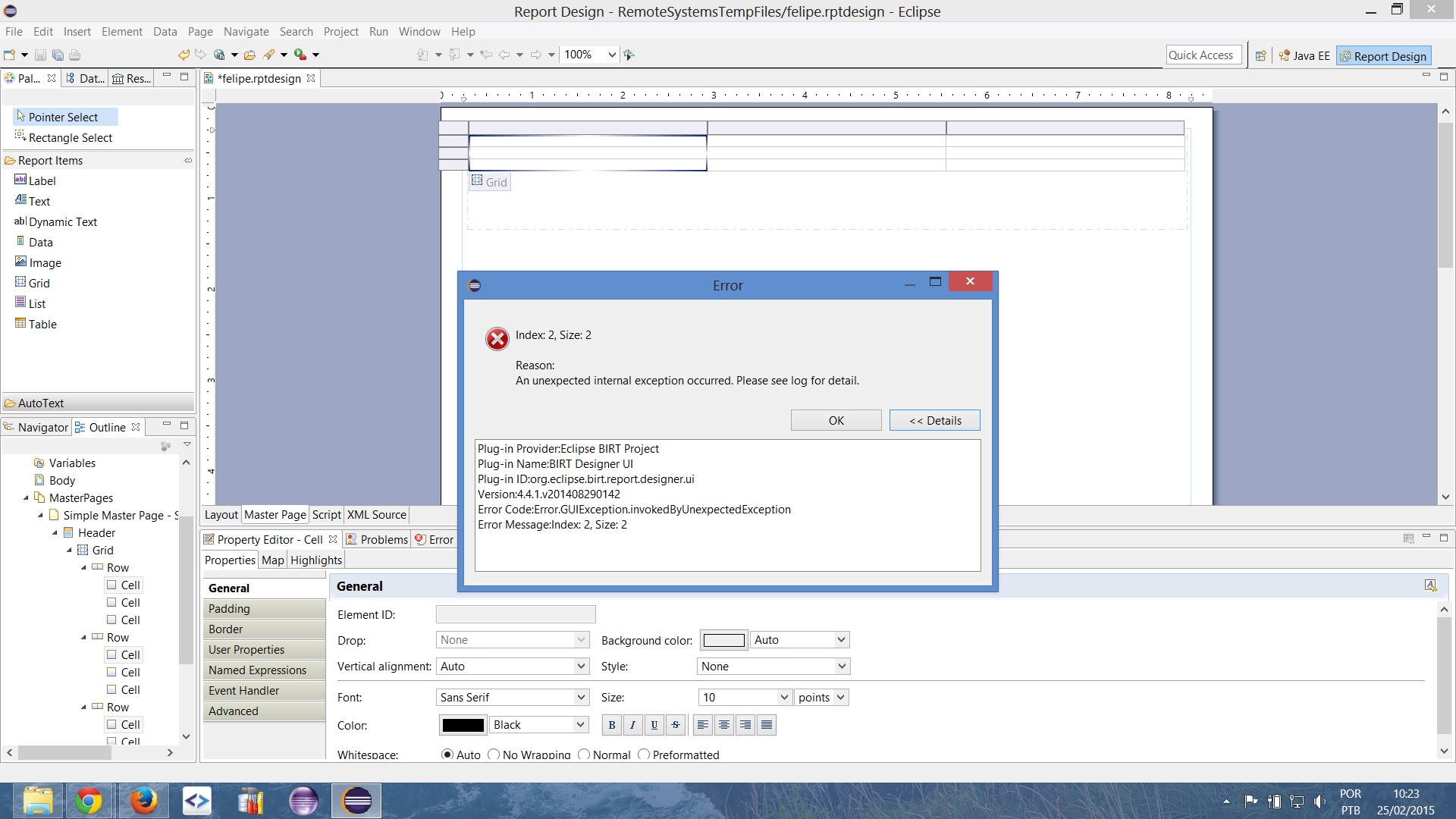

Hi guys.
So, i'm facing a strange exception error when i try to merge cells on the Grid. I select the rows that i want to merge, i click on the right button at mouse and choose merge cells, and a strange error message is thrown:
Index: 1, Size: 1
Reason:
An unexpected internal expcetion ocurred. Please see log for detail.
Details message:
An unexpected internal exception occurred. Please see log for detail.
Plug-in Provider:Eclipse BIRT Project
Plug-in Name:BIRT Designer UI
Plug-in ID:org.eclipse.birt.report.designer.ui
Version:4.4.1.v201408290142
Error Code:Error.GUIException.invokedByUnexpectedException
Error Message:Index: 1, Size: 1
I cannot use the previous version of Eclipse with Birt because the other versions has a bug that does not work with libraries.
How can i solve this strange issue ?
Thank you!
Attached to the error image.

For those interested, is a known bug and is in resolution:
Bug number: 455339
Waiting anxiously for correction......
Re: Unexpected exception when I try to merge grid lines [message #1650396 is a reply to message #1635260] Wed, 04 March 2015 15:24 Go to previous message
As a heads up, the bug number you provided is a duplicate of 446077.
There is a patch available for this issue with 446077: https://bugs.eclipse.org/bugs/show_bug.cgi?id=446077
And it should be resolved in the 4.5 release.
