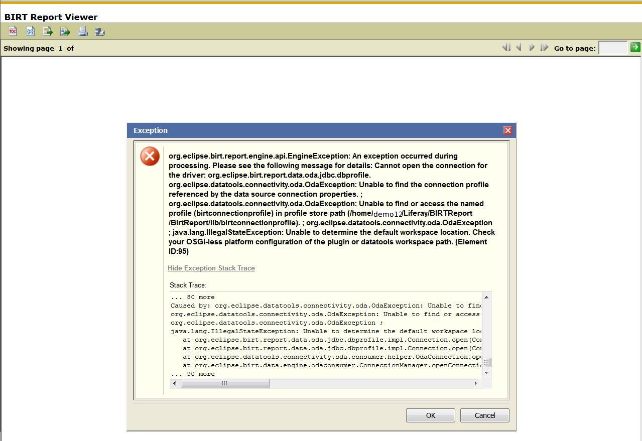

I have generated a "***.rptdesign***" file and I have deployed it in tomacat server from windows OS it is working.Same file I deployed in tomacat server from Ubuntu OS is not working and it throwing the Exception. It is working in windows but not in Ubuntu.Some one facing the same issues? How to resolve the bug?
Exception:
org.eclipse.birt.report.engine.api.EngineException: An exception occurred during processing. Please see the following message for details:
    Cannot open the connection for the driver:
    org.eclipse.birt.report.data.oda.jdbc.dbprofile.
    org.eclipse.datatools.connectivity.oda.OdaException: Unable to find the connection profile referenced by the data source connection properties. ;
    org.eclipse.datatools.connectivity.oda.OdaException: Unable to find or access the named profile (birtconnectionprofile) in profile store path (/home/pro/Liferay/BIRTReport/BirtReport/lib/birtconnectionprofile). ;
    org.eclipse.datatools.connectivity.oda.OdaException ;
    java.lang.IllegalStateException: Unable to determine the default workspace location. Check your OSGi-less platform configuration of the plugin or datatools workspace path. (Element ID:95)

Screen shot below
![enter image description here][2]
Embarrassed
  • Attachment: Capture.JPG
    (Size: 147.46KB, Downloaded 3671 times)
