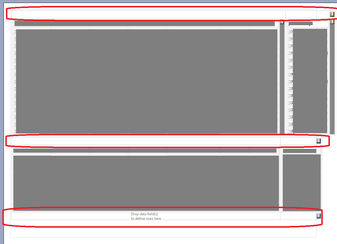

I have included a screenshot of the rpt design and of the xls output.
Here on the .rptdesign, I have marked with red the area that I want to eliminate from appearing on the output.
index.php/fa/20904/0/

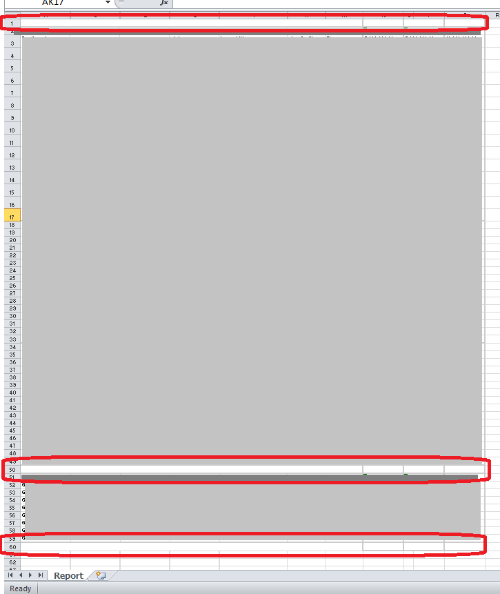

And here, on the .xls file, I have also marked with red the rows that appear and should not appear there.
index.php/fa/20906/0/
Can this be done via a script? If so, I'd like to know how to write that and where exactly, on which function to place it. I have researched sure scripts, but haven't been able to successfully implement a functional one.

Found solution: I selected each cell of the crosstab, went to its Property Editor -> Advanced -> Section -> Display -> set display to "No Display"
Re: Birt 4.3.1 - Crosstab - Hiding default empty rows [message #1624245 is a reply to message #1624193] Thu, 19 February 2015 12:07 Go to previous message
The screenshots helped a lot in letting me see what you were meaning. You have the solution I would have suggested after seeing those. Glad you found it. Smile Let us know if you run into any other issues.
