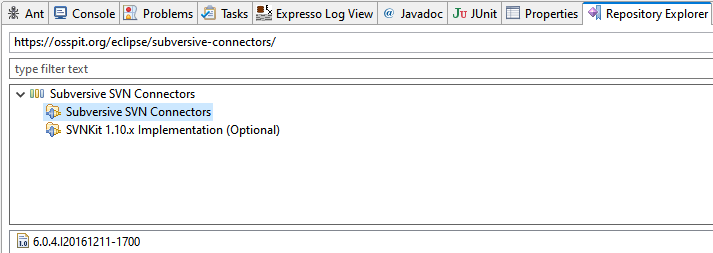

The 4.8 install instructions references a new site: https://osspit.org/eclipse/subversive-connectors/ . But it only has the SVNKit 1.10 connector.
index.php/fa/42752/0/
