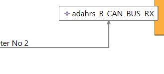

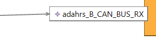

I have diagrams look like this index.php/fa/36826/0/
well, that picture looks ideal, but sometimes the layout looks like this:
index.php/fa/36827/0/
I want to make sure the end of edge connect to the left border of the node all the time, I already tried the End Centering property but that's not what I want.
thanks.

Hi Qiran,
There is no direct way to achieve this with the properties of the edge mapping in the VSm editor.
One way to force this would be to provide an additional border node mapping on your white node mapping with the same domain class and aql:self as semantic candidates expression.
Then you would put a style (for example a small svg, with Autorized sides set to WEST only). You might add a CompositeFilterApplication with a MappingFilter (Collapse) to let the user collapse those nodes.
Then you will have to change your edge mapping to use this new node mapping as source and/or target.
Another way would be to provide your own set of EditPart/EditPolicy (and maybe even locator, anchor, figure..) implementation to be able to force the wanted behavior.
