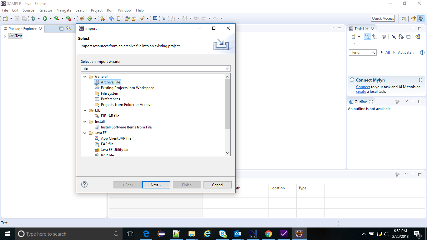

As you mentioned to use context workspace, workspace will be loaded earlier before the test case is ran. I want to use the folders and files within the RCPTT tool for importing files and projects in the test case. I doesn't want to give absolute path from my system, is it possible to keep the files and folders in RCPTT tool to use it in the test cases. I mean to say that while context will be loaded earlier when the test case is ran.
If Project is present in workspace while recording, using test script i want to import any file(file should be present within in RCPTT) to the project present in workspace.
If it is possible please give me suggestions.
I have attached the screenshot which is same as my scenario, instead of giving path to browse files from local system. I want use the path of the file in RCPTT.

Since you cannot specify relative path in the 'import' dialog, you may try to put files somewhere on disk (not to workspace) and generate an absolute path
To put files somewhere on the disk, you can use 'folder' context: https://www.eclipse.org/rcptt/documentation/userguide/contexts/folder/
I created an example project to show how it can be used (a separate RCPTT instance is used as AUT in this project, you should be able to run it)
The main idea is that we should calculate an absolute path in the test because it should be specified in the 'import' dialog (and we cannot specify a relative path)
