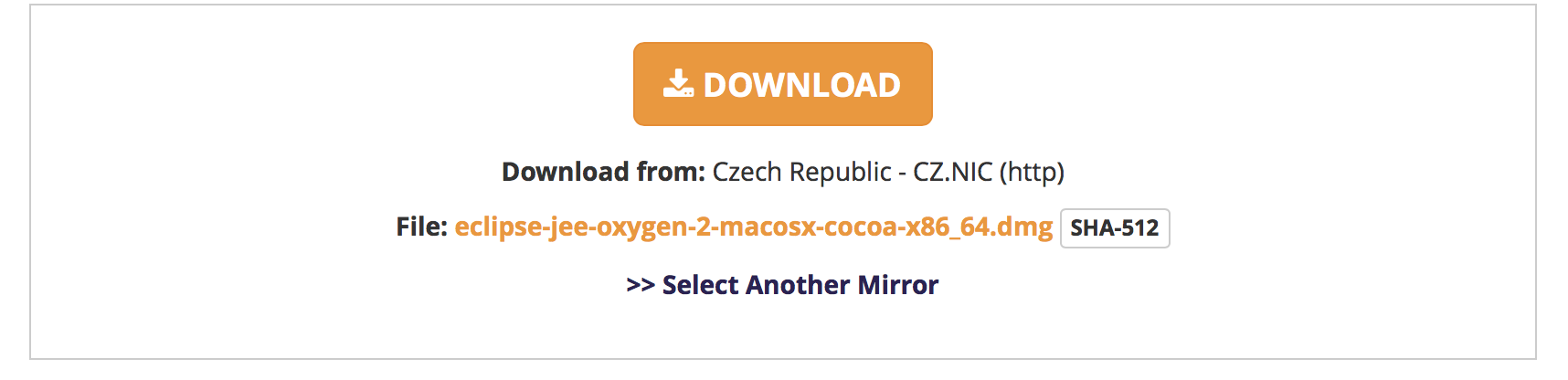

I've then created a folder called Java on my desktop and unzipped the file in the folder. When I click on the eclipse shortcut in the unzipped Eclipse Oxygen file i'm getting the following error Message - "The application "Eclipse" cannot be opened
I've installed all the above Windows versions on my windows laptop and it all works fine. However, i want to code on my Mac. Please can you advise on what the problem is and how i can fix it.
I've looked at other threads but none seem to have the same issue. I've attached screenshots of the files i've downloaded.
Thanks in advance for your help.
Re: Eclipse Oxygen - Error Message "The application "Eclipse" cannot be opened [message #1779267 is a reply to message #1779246] Thu, 04 January 2018 10:44 Go to previous messageGo to next message
Hi Gareth,
The file you downloaded for Mac should have been a "DMG" file, not an archive. You can simply "run" that file to install Eclipse in the Mac's Applications folder. You do not need to unzip that file...
Re: Eclipse Oxygen - Error Message "The application "Eclipse" cannot be opened [message #1779268 is a reply to message #1779267] Thu, 04 January 2018 10:54 Go to previous messageGo to next message
Thanks for the quick response. It worked.
