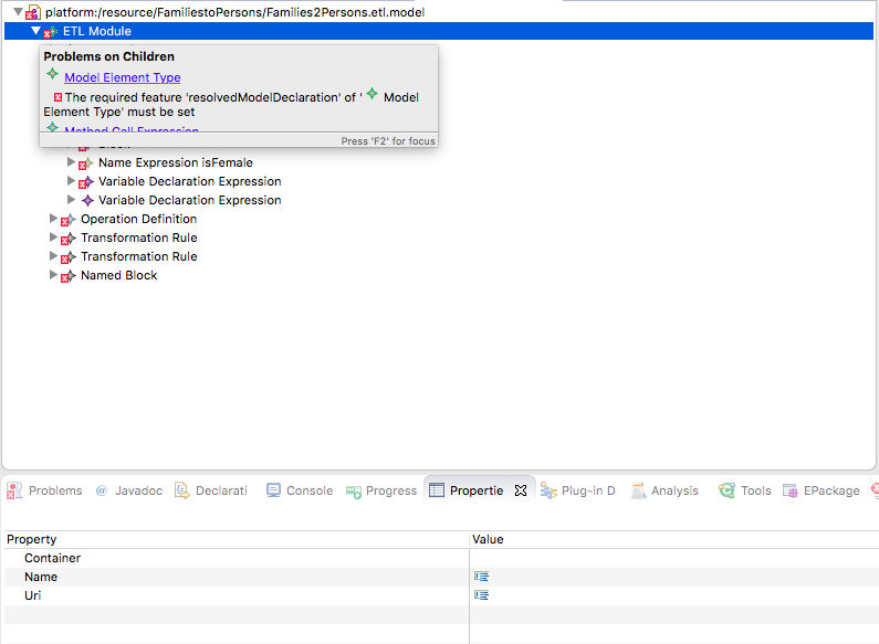

On my Eclipse it generates some parsing problems:
org.eclipse.emf.ecore.resource.impl.ResourceSetImpl$1DiagnosticWrappedException: org.eclipse.emf.ecore.xmi.IllegalValueException: Value 'org.eclipse.emf.ecore.impl.DynamicEObjectImpl@de646d5 (eClass: org.eclipse.emf.ecore.impl.EClassImpl@79cbc176 (name: OperationDefinition) (instanceClassName: null) (abstract: false, interface: false))' is not legal. (platform:/resource/emf.test/model/Families2Persons.etl.model, 12, 120)
at org.eclipse.emf.ecore.resource.impl.ResourceSetImpl.handleDemandLoadException(ResourceSetImpl.java:319)
at org.eclipse.emf.ecore.resource.impl.ResourceSetImpl.demandLoadHelper(ResourceSetImpl.java:278)
at org.eclipse.emf.ecore.resource.impl.ResourceSetImpl.getResource(ResourceSetImpl.java:406)
at org.eclipse.emf.ecore.presentation.EcoreEditor.createModelGen(EcoreEditor.java:1173)
at org.eclipse.epsilon.dt.exeed.ExeedEditor.createPages(ExeedEditor.java:311)
at org.eclipse.ui.part.MultiPageEditorPart.createPartControl(MultiPageEditorPart.java:363)
at org.eclipse.ui.internal.e4.compatibility.CompatibilityPart.createPartControl(CompatibilityPart.java:150)
at org.eclipse.ui.internal.e4.compatibility.CompatibilityEditor.createPartControl(CompatibilityEditor.java:99)
at org.eclipse.ui.internal.e4.compatibility.CompatibilityPart.create(CompatibilityPart.java:340)
Did you change Haetae source code or its metamodel in your local copy?
Cheers,
Will
Re: EOL stansalone problem [message #1771937 is a reply to message #1771935] Fri, 01 September 2017 06:50 Go to previous messageGo to next message
I think I only add "org.eclipse.epsilon.common.dt.tool" extension to "org.eclipse.epsilon.haetae.eol.metamodel.visitor.printer" for using "EolPrinter" as a tool but I'm not sure.
I transformed the attached etl transformation to model with Haetae. Does your achieved model has a difference with my model?
[Updated on: Fri, 01 September 2017 06:52] by Moderator

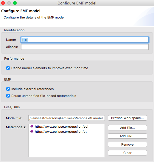

The eol program which has the Families2Persons.etl.model as its input model runs well via run configuration. However, when I try to run it via standalone, it has an error.
I created the model via the below statement in standalone in which model variable contains such a "/FamiliestoPersons/Families2Persons.etl.model" string:
models.add(createEmfModelByURI("ETL", model, "http://www.eclipse.org/epsilon/etl", true, false));

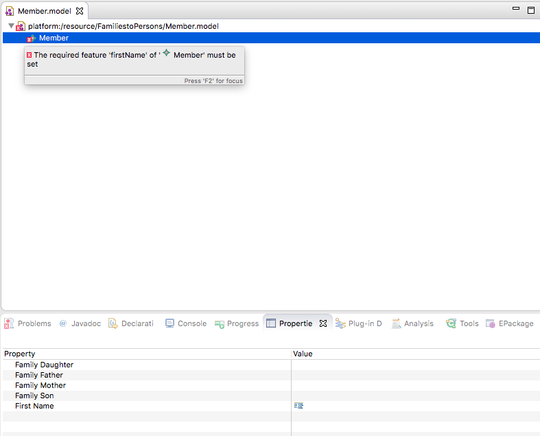

Re: EOL stansalone problem [message #1771953 is a reply to message #1771951] Fri, 01 September 2017 09:17 Go to previous messageGo to next message
It seems there is a problem with my new instance of eclipse because all of my model have an error such as attached files.
would you please try the new attached model? I achieved it in my first eclipse and it doesn't have an error for me.
[Updated on: Fri, 01 September 2017 09:19] by Moderator

Re: EOL stansalone problem [message #1772042 is a reply to message #1772009] Mon, 04 September 2017 10:26 Go to previous messageGo to next message
We have spotted some problems with the ETL.ecore, introduced probably in the last refactor phase. It has now been rectified.
I have attached the ETL model generated from your transformation. Please give it another try.
Please also update the changes from haetae repository.

Re: EOL stansalone problem [message #1772271 is a reply to message #1772262] Thu, 07 September 2017 06:28 Go to previous messageGo to next message
Hi there, I have figured out what the problem is:
When you configure a model and specify the .model file in the run configuration, it shows what metamodels it conform to, but the metamodels are not actually in the EPackage registry. I have made some changes to the plug-ins so that these metamodels are registered when you run a new Eclipse instance.
Your code should work now, please update your source from github.
