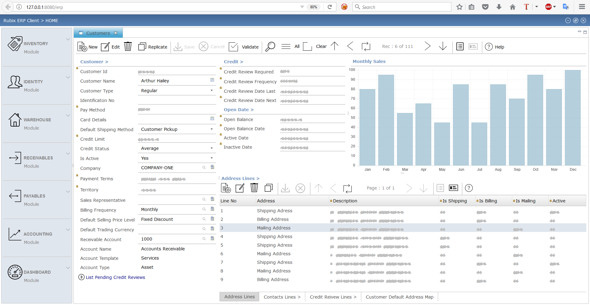

We're using org.eclipse.rap.chartjs as our RAP chart provider and org.swtchart as our RCP chart provider. We have separate targets for each RCP and RAP with respective bundles.
RAP includes chartjs bundle.
Everything works fine until we start RAP client in multi sessions.

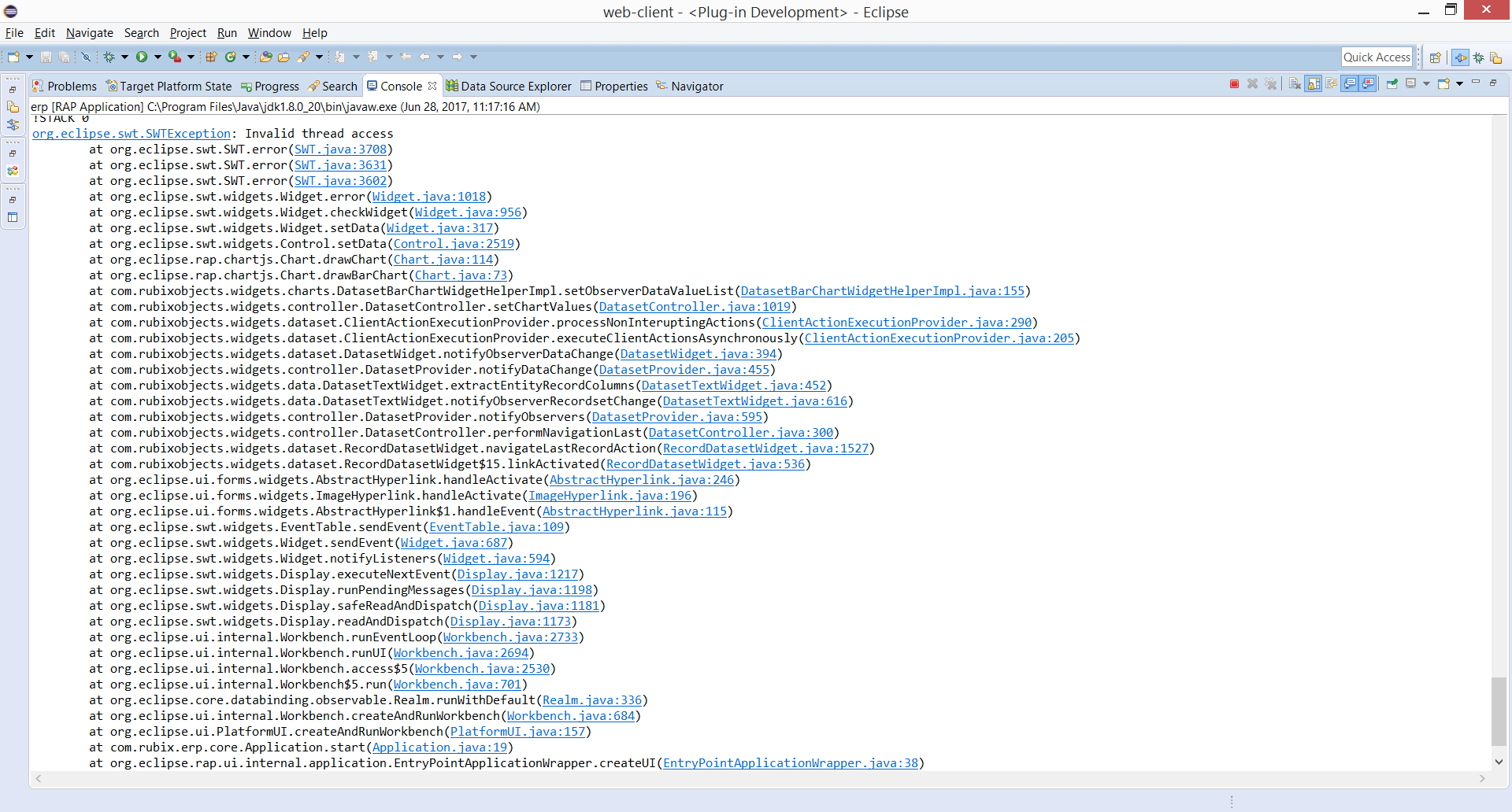

We get following error !
Invalid thread access exception
I tried to wrap the redraw() method of Chart.java around asyncExec, but still the same issue when running multi sessions, opening the same editor with chart.
Display.getDefault().asyncExec(new Runnable() {
        public void run() {
                redraw();
any idea how to fix ?
if i remove the chart from the editor, everything works fine ! (multi sessions)
FYI > multi session throws error, only after starting record navigation from both sessions, where respective data is loaded to chart for each record. Just opening the editor with chart without record actions, in both sessions do not throw the error and i can see the chart with data immediately after loading both editors. Only when we start interacting with both editors(multi sessions) using record actions, it throws the following exception.
org.eclipse.swt.SWTException: Invalid thread access
	at org.eclipse.swt.SWT.error(SWT.java:3708)
	at org.eclipse.swt.SWT.error(SWT.java:3631)
	at org.eclipse.swt.SWT.error(SWT.java:3602)
	at org.eclipse.swt.widgets.Widget.error(Widget.java:1018)
	at org.eclipse.swt.widgets.Widget.checkWidget(Widget.java:956)
	at org.eclipse.swt.widgets.Widget.setData(Widget.java:317)
	at org.eclipse.swt.widgets.Control.setData(Control.java:2519)
	at org.eclipse.rap.chartjs.Chart.drawChart(Chart.java:122)
	at org.eclipse.rap.chartjs.Chart.drawBarChart(Chart.java:74)
	at com.rubixobjects.widgets.charts.DatasetBarChartWidgetHelperImpl.setObserverDataValueList(DatasetBarChartWidgetHelperImpl.java:156)
	at com.rubixobjects.widgets.controller.DatasetController.setChartValues(DatasetController.java:1019)
	at com.rubixobjects.widgets.dataset.ClientActionExecutionProvider.processNonInteruptingActions(ClientActionExecutionProvider.java:290)
	at com.rubixobjects.widgets.dataset.ClientActionExecutionProvider.executeClientActionsAsynchronously(ClientActionExecutionProvider.java:205)
	at com.rubixobjects.widgets.dataset.DatasetWidget.notifyObserverDataChange(DatasetWidget.java:394)
	at com.rubixobjects.widgets.controller.DatasetProvider.notifyDataChange(DatasetProvider.java:455)
	at com.rubixobjects.widgets.data.DatasetTextWidget.extractEntityRecordColumns(DatasetTextWidget.java:452)
	at com.rubixobjects.widgets.data.DatasetTextWidget.notifyObserverRecordsetChange(DatasetTextWidget.java:616)
	at com.rubixobjects.widgets.controller.DatasetProvider.notifyRecordViewObservers(DatasetProvider.java:621)
	at com.rubixobjects.widgets.dataset.RecordDatasetWidget.recordViewAction(RecordDatasetWidget.java:1802)
	at com.rubixobjects.widgets.controller.DatasetProvider.notifyRecordView(DatasetProvider.java:609)
	at com.rubixobjects.widgets.detailtable.DatasetDetailTable$4.doubleClick(DatasetDetailTable.java:399)
	at org.eclipse.jface.viewers.StructuredViewer$1.run(StructuredViewer.java:828)
	at org.eclipse.ui.internal.JFaceUtil$1.run(JFaceUtil.java:52)
	at org.eclipse.jface.util.SafeRunnable.run(SafeRunnable.java:177)
	at org.eclipse.jface.viewers.StructuredViewer.fireDoubleClick(StructuredViewer.java:826)
	at org.eclipse.jface.viewers.StructuredViewer.handleDoubleSelect(StructuredViewer.java:1139)
	at org.eclipse.jface.viewers.StructuredViewer$4.widgetDefaultSelected(StructuredViewer.java:1251)
	at org.eclipse.jface.util.OpenStrategy.fireDefaultSelectionEvent(OpenStrategy.java:242)
	at org.eclipse.jface.util.OpenStrategy.access$0(OpenStrategy.java:239)
	at org.eclipse.jface.util.OpenStrategy$1.handleEvent(OpenStrategy.java:304)
	at org.eclipse.swt.widgets.EventTable.sendEvent(EventTable.java:109)
	at org.eclipse.swt.widgets.Widget.sendEvent(Widget.java:687)
	at org.eclipse.swt.widgets.Widget.notifyListeners(Widget.java:594)
	at org.eclipse.swt.widgets.Display.executeNextEvent(Display.java:1217)
	at org.eclipse.swt.widgets.Display.runPendingMessages(Display.java:1198)
	at org.eclipse.swt.widgets.Display.safeReadAndDispatch(Display.java:1181)
	at org.eclipse.swt.widgets.Display.readAndDispatch(Display.java:1173)
	at org.eclipse.ui.internal.Workbench.runEventLoop(Workbench.java:2733)
	at org.eclipse.ui.internal.Workbench.runUI(Workbench.java:2694)
	at org.eclipse.ui.internal.Workbench.access$5(Workbench.java:2530)
	at org.eclipse.ui.internal.Workbench$5.run(Workbench.java:701)
	at org.eclipse.ui.internal.Workbench.createAndRunWorkbench(Workbench.java:684)
	at org.eclipse.ui.PlatformUI.createAndRunWorkbench(PlatformUI.java:157)
	at com.rubix.erp.core.Application.start(Application.java:19)
	at org.eclipse.rap.ui.internal.application.EntryPointApplicationWrapper.createUI(EntryPointApplicationWrapper.java:38)
	at org.eclipse.rap.rwt.internal.lifecycle.RWTLifeCycle.createUI(RWTLifeCycle.java:177)
	at org.eclipse.rap.rwt.internal.lifecycle.RWTLifeCycle$UIThreadController.run(RWTLifeCycle.java:290)
	at java.lang.Thread.run(Thread.java:745)

Re: Invalid Thread Access exception throws when using ChartJs during multiple sessions [message #1766892 is a reply to message #1766889] Wed, 28 June 2017 11:13 Go to previous messageGo to next message
I see only static string constants.
The stack trace is similar to another one, posted in the newsgroup recently. Is it possible to create a simple demo project (or patch against our workbench demo) to demonstrate the issue?
Ivan

Re: Invalid Thread Access exception throws when using ChartJs during multiple sessions [message #1766913 is a reply to message #1766903] Wed, 28 June 2017 13:00 Go to previous messageGo to next message
Hi Sudesh,
everything looks good and the single-source approach you choose is perfectly fine. Are you calling org.eclipse.rap.chartjs.Chart.drawBarChart() from a non UI thread? Use Thread.currentThread() to dump the current thread before calling redraw. It seems this thread is different from the thread returned by chart.getDisplay().getThread();
Try to wrap drawBarChart in asyncExec like:
chart.getDisplay().asyncExec( new Runnable() {
HTH,
Ivan
Re: Invalid Thread Access exception throws when using ChartJs during multiple sessions [message #1766928 is a reply to message #1766913] Wed, 28 June 2017 14:29 Go to previous messageGo to next message
Hello Ivan,
In my DatasetBarChartWidgetHelperImpl chart implementation provider, i'm calling the drawBarChart like this.
Now the behavior is somewhat different, the latest session gets the upper hand and the previous ones don't draw chart data during record navigation.
However the application is not throwing Invalid thread exception any more and the other parts remain to load the data during navigation.
Change >>
                if (chart != null && chart.isDisposed() == false) {
			chart.getDisplay().asyncExec(new Runnable() {
				public void run() {
					chart.drawBarChart(chartrowdata, options);

Re: Invalid Thread Access exception throws when using ChartJs during multiple sessions [message #1766964 is a reply to message #1766928] Thu, 29 June 2017 03:06 Go to previous messageGo to next message
Hi Sudesh,
I can't say anything more. You have to debug it yourself. What is the thread in your provider? What is the thread (display/ uiSession) in your chart? Is it possible for you not to create UI from non UI thread? All these questions must be answered during the debugging. But for me the main question is - what is the thread in DatasetBarChartWidgetHelperImpl? Is this thread executed outside a request? Maybe you need syncExec instead of asyncExec?
Ivan
Re: Invalid Thread Access exception throws when using ChartJs during multiple sessions [message #1767206 is a reply to message #1766964] Mon, 03 July 2017 10:39 Go to previous message
Hello Ivan,
Found the solution !!!
If we look at single sourcing implementation provider below, we call the create method. This method always return same object instance which internally creates a new chart every time. So basically the same object(DatasetBarChartWidgetHelperImpl) is shared with multiple charts widgets across sessions. We made changes to return new object(DatasetBarChartWidgetHelperImpl) having a new chart for each instance, and it worked !
public abstract class DatasetBarChartWidgetHelper extends BaseDatasetWidget {
	private static final DatasetBarChartWidgetHelper IMPL;
	static {
		IMPL = (DatasetBarChartWidgetHelper) ImplementationLoader.newInstance(DatasetBarChartWidgetHelper.class);
	public static Object createWidget(final String name, final String caption, final IDatasetBroadcast datasetBroadcast,
			final Composite composite, final EntityObject entity, final List<ChartConfiguration> chartConfigurations) {
		return IMPL.create(name, caption, datasetBroadcast, composite, entity, chartConfigurations);
	protected abstract Object create(final String name, final String caption, final IDatasetBroadcast datasetBroadcast,
			final Composite composite, final EntityObject entity, final List<ChartConfiguration> chartConfigurations);
OLD this basically returns the same object with new chart for every call, so the object itself is shared
public class DatasetBarChartWidgetHelperImpl extends DatasetBarChartWidgetHelper
		implements IDatasetObserver, IDatasetChartObserver {
	private Chart chart;
	protected Object create(final String name, final String caption, final IDatasetBroadcast datasetBroadcast,
		setDatasetBroadcast(datasetBroadcast);
		datasetBroadcast.addObserver(this);
		this.name = name;
		// chart-composite
		final Composite chartComposite = new Composite(composite, SWT.NONE);
		chartComposite.setBackgroundMode(SWT.INHERIT_DEFAULT);
		chartComposite.setBackground(Display.getDefault().getSystemColor(SWT.COLOR_WHITE));
		final FormLayout layout = new FormLayout();
		layout.marginWidth = 0;
		layout.marginHeight = 0;
		layout.marginLeft = 0;
		layout.marginRight = 0;
		layout.marginTop = 0;
		layout.marginBottom = 0;
		chartComposite.setLayout(layout);
		final FormData data = new FormData();
		data.left = new FormAttachment(0);
		data.right = new FormAttachment(100);
		data.top = new FormAttachment(0);
		data.bottom = new FormAttachment(100);
		chartComposite.setLayoutData(data);
		// header
		final CLabel header = new CLabel(chartComposite, SWT.NONE);
		header.setText(caption);
		header.setForeground(new Color(chartComposite.getDisplay(), 112, 146, 190));
		header.setFont(JFaceResources.getFontRegistry().getBold(JFaceResources.DEFAULT_FONT));
		FormData formData = new FormData();
		formData.left = new FormAttachment(0, 7);
		formData.right = new FormAttachment(100);
		formData.top = new FormAttachment(0, 7);
		header.setLayoutData(formData);
		// separator
		final Label seperator = new Label(chartComposite, SWT.SEPARATOR | SWT.SHADOW_OUT | SWT.HORIZONTAL);
		formData.top = new FormAttachment(header);
		seperator.setLayoutData(formData);
		// chart
		chart = new Chart(chartComposite, SWT.NONE);
		formData.left = new FormAttachment(0);
		formData.top = new FormAttachment(seperator);
		formData.bottom = new FormAttachment(100);
		chart.setLayoutData(formData);
		final EntityColumn column = entity.getChartByName(name);
		final String[] namesarray = new String[((IChartEntityColumn) column).getItems().size()];
		final int[] valuesarray = new int[((IChartEntityColumn) column).getItems().size()];
		for (int index = 0; index < ((IChartEntityColumn) column).getItems().size(); index++) {
			namesarray[index] = ((IChartEntityColumn) column).getItems().get(index).getName();
			valuesarray[index] = ((IChartEntityColumn) column).getItems().get(index).getValue().intValue();
		final ChartOptions options = new ChartOptions();
		options.setAnimation(true);
		options.setShowToolTips(true);
		options.setScaleBeginAtZero(true);
		options.setBezierCurve(true);
		options.setShowFill(true);
		options.setScaleShowLabels(true);
		options.setPointDotRadius(3);
		options.setStrokeWidth(1);
		final ChartStyle chartStyle = new ChartStyle(151, 187, 205, 0.7f);
		chartStyle.setPointColor(new RGB(100, 220, 100));
		final ChartRowData chartrowdata = new ChartRowData(namesarray).addRow(valuesarray, chartStyle);
		return this;
NEW this basically returns the new object with new chart for every call, so the object itself is not shared
public class DatasetBarChartWidgetHelperImpl extends DatasetBarChartWidgetHelper {
		return new DatasetBarChartWidget(name, caption, datasetBroadcast, composite, entity, chartConfigurations);
By delegating the DatasetBarChartWidgetHelperImpl to return new instance(DatasetBarChartWidget) for each create method call, now we can keep multiple sessions in perfect harmony.
Thanks Ivan for your valuable suggestions.
Will be starting to integrate Apache Shiro with Rubix framework to implement permission and access control. Will keep you posted further developments.
Sudesh
[Updated on: Mon, 03 July 2017 10:43] by Moderator
