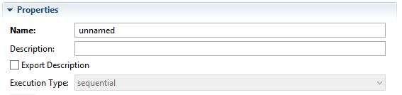

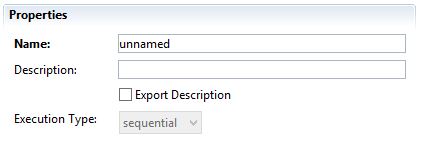

Are there plans to add more features to the built-in layouts? For instance, there is no way to edit the GridData of the GridLayout.

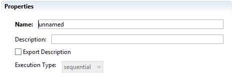

Compared to the old EEF properties, the new default layout has the checkboxes shifted to the right one column and select widgets are not filling the horizontal space. If I use a new GridLayout, I now have bigger margins, select is still not filling and now I can't line up the columns. FillLayout looks the same as GridLayout with one column.
Please see attachment examples.

Thanks for your feedback, you will find some answers below but first of all, let me start by saying that keeping the exact same appearance as EEF (1.5.x and before) was not one of our major goal with the brand new version of EEF (1.6 and after). Since we have started with a new approach from scratch, some things may be quite different, some better and some worse, hopefully not a lot Smile
1) The new default layout for checkboxes (shifted to the right column) is the new expected behavior (we have tested several options with their various tradeoffs before making this decision). I don't believe that we will change that since the impact of such a change may not be trivial.
2) I don't think that we had a specific reason to use this approach for the new default layout for the select widget. We could fill the horizontal space by default, it's something that should be discussed with the team.
3) The result that you have with the grid layout is odd, at the very least the columns should be lined up... Can you share here a small odesign showing this issue?
4) The fill layout is implemented using a grid layout since we can have an enormous amount of variation of containers and widgets etc, it was far easier to consider that everything is a grid layout in order to manage the various layouts and their layout data.
I don't know if the issue with the column of the grid layout is coming from your use of the grid layout or from our code (or both Razz) but your feedback raises another question regarding the detailed manipulation of the grid data. I am not sure that we want to expose this option declaratively in the odesign, it seems way to specific and complex for each widget (we can still change or improve our default behavior). If you really really really want to change the grid data of a widget, for example the select widget, you may be able to do it with another approach (depending on the widget and its implementation).

3. I should be more specific. When I said line up the columns, I meant that I expected the labels to be in column and the widgets to be lined up in their column which is not the case. So, this is probably miscommunication on my part. The default layout seems to be what I am looking for anyways. I have attached an odesign anyways. Container in question is in group: org.eclipse.sirius.ui.properties.groupBatch
