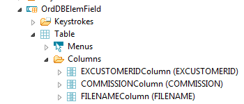

I have a similar problem and to solve it I followed what write in this post but continues to give me an error. I've tried both ways shown but the same error occurs.
This is my method on the server side
  public CompareTestFormData loadDBOrdList(Date dateToUse, CompareTestFormData formData) throws ProcessingException {
    String SQLcmd = "SELECT CC_CHARGE.EXCUSTOMERID, CC_CHARGE.COMMISSION, CC_CHARGEFILE.FILENAME FROM CC_CHARGE INNER JOIN CC_CHARGEFILE ON CC_CHARGE.CHARGEFILEID=CC_CHARGEFILE.CHARGEFILEID WHERE CC_CHARGE.CHARGETYPEID=12";
    SimpleDateFormat sdf = new SimpleDateFormat("yyyy-MM-dd HH:mm:ss");
    System.out.println(sdf.format(dateToUse).substring(0, 10));
    SQLcmd += " AND NVL ( INCOMINGDATE , TO_DATE ( '1900-01-01 00:00' , 'YYYY-MM-DD HH24:MI' ) ) >= TO_DATE ( '" + sdf.format(dateToUse).substring(0, 10) + " 00:00' , 'YYYY-MM-DD HH24:MI' ) AND NVL ( INCOMINGDATE , TO_DATE ( '1900-01-01 00:00' , 'YYYY-MM-DD HH24:MI' ) ) <= TO_DATE ( '" + sdf.format(dateToUse).substring(0, 10) + " 23:58' , 'YYYY-MM-DD HH24:MI' ) ";
    SQLcmd += " INTO :EXCUSTOMERID,"
        + "      :COMMISSION,"
        + "      :FILENAME";
    SQL.select(SQLcmd, formData.getOrdDBElem());
    return formData;
In the form is defined this table
index.php/fa/22499/0/
and all three fields are defined as String

Thanks in advance for any help and explanation

Re: Populate multi column TableField Table in form with data [message #1702336 is a reply to message #1701638] Tue, 21 July 2015 11:38 Go to previous message
Form your stacktrace, I guess that you have a problem with your sql query:
ORA-00942: table or view inexistent
My guess is that your query without the INTO part, does not run in your SQL client:
FROM      CC_CHARGE
ON        CC_CHARGE.CHARGEFILEID = CC_CHARGEFILE.CHARGEFILEID
WHERE     CC_CHARGE.CHARGETYPEID = 12
          AND NVL(INCOMINGDATE, TO_DATE('1900-01-01 00:00', 'YYYY-MM-DD HH24:MI')) >= TO_DATE('2015-07-14 00:00', 'YYYY-MM-DD HH24:MI')
          AND NVL(INCOMINGDATE, TO_DATE('1900-01-01 00:00', 'YYYY-MM-DD HH24:MI')) <= TO_DATE('2015-07-14 23:58', 'YYYY-MM-DD HH24:MI')
Your problem might not be releated with scout at all...
