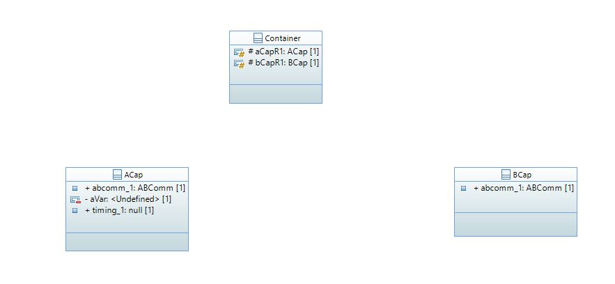

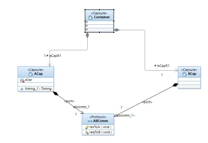

Thank you very much for the informative reply. I did able to import a simple RSA-RTE model following your instructions. And, yes, I also found that all the diagrams are yet to be supported for the import feature.
For reporting an issue, here I attached a screenshot of the simple RSA-RTE model I imported and a screenshot of the corresponding model I got from Papyrus after importing. As we can see, some transitions and the protocol are missing from the Papyrus model.

If I'm not mistaken, the Protocol is a Collaboration. Collaborations are not supported in Papyrus Class Diagrams. The RSA Class Diagram is a mix of Class Diagram and Composite Structure Diagram, whereas Papyrus has a clear distinction; so a perfect import is not possible (At least not yet).
For the missing Compositions, it is much more intriguing however. They are supposed to be supported.

I guess one explanation could be that what looks like a composition association is actually just an attribute (capsule part) being visualized as a directed composition association. It does not actually exist an association in the model. RSA(RTE) has a feature where you can choose to display any (typed) attribute as an assocation, even though it is just a plain attribute. I do not know if Papyrus has such a feature. Could this be the explanation why the composition of the capsule parts are missing?
The same actually goes for the "composition" of the protocol. That is also just a visualization of a port, being typed by the protocol, in form of a directed compositions association. The stereotype <<port>> (as can be seen in the screen shot from RSARTE) is actually displayed only in the diagram. The actual stereotype from the UML RealTIme profile applied on the port is named <<RTPort>>.
/Peter Cigéhn

Indeed, Papyrus doesn't support "references" yet. There is an enhancement request for that, and hopefully it will be available in the next version:
444605: [ClassDiagram] Display references (properties) with the Association notation
https://bugs.eclipse.org/bugs/show_bug.cgi?id=444605
