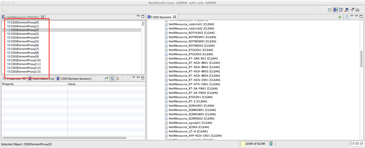

1. When using the CDO UI (Which I integrated in NetXStudio), I get
sometimes objects in the proxy state, see attached screenshot.
(Properties are empty). I would like to understand, why the object is
not simply proxy resolved and showed?.

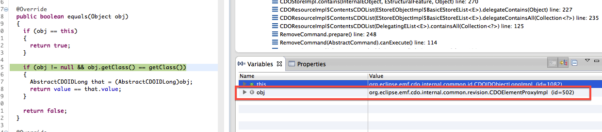

2. Some time ago, I registered this bug:
https://bugs.eclipse.org/bugs/show_bug.cgi?id=316273
Although the bug is closed, I still don't have this working properly.
A new debug round revealed today that, the equality (code snippet below)
fails when the object to compare is of type CDOProxyElement.
(See 2nd attached screenshot).
public boolean equals(Object obj)
if (obj == this)
return true;
if (obj != null && obj.getClass() == getClass())
AbstractCDOIDLong that = (AbstractCDOIDLong)obj;
return value == that.value;
return false;

> 1. When using the CDO UI (Which I integrated in NetXStudio), I get sometimes objects in the proxy state, see attached
> screenshot. (Properties are empty). I would like to understand, why the object is not simply proxy resolved and showed?.
Hmm, are you confusing the CDOState.PROXY of a CDOObject with a CDOElementProxy in a CDOList? They're totally different
things.
If the already reported problem still occurs please reopen that bugzilla, otherwise plese open a new one.
> A new debug round revealed today that, the equality (code snippet below) fails when the object to compare is of type
> CDOProxyElement.
You mean CDOElementProxy?
> @Override
> if (obj == this)
> return true;
> return false;
I can't find this equals() method in CDOElementProxyImpl. Where is it?

I am talking about CDOElementProxy, in the attached screenshot the
objects in the UI show as an CDOElementProxy. Why is this? The objects
in concerned have certain attributes, which I would expect to show by
an EMF.Edit Content provider. Is this a know limitation of the CDO Ui,
or is something wrong? If this is viewer is using an
AdapterFactoryLabelProvider, the ItemProvider's getText() method would
access it's attribute and it would then resolve?

Only now, I understand why the problem as described occurs, perhaps
a new bug is better fitted.
>> below) fails when the object to compare is of type CDOProxyElement.
Yes, sorry.
>> @Override
>> if (obj == this)
>> return true;
>> return false;
I am referring to the equals method in AbstractCDOIDLong which is in the
case of this bug is called along the stack in the RemoveCommand

Yes, but I notice that when an objects stays CDOElementProxy until I
access the content of one of it's contained multi-valued features. See
my first attached screenshot.
RemoveCommand =>
protected boolean prepare()
// This can execute if there is an owner list and a collection and
the owner list contains all the objects of the collection.
boolean result =
ownerList != null &&
collection != null &&
1. ownerList.containsAll(collection) &&
(owner == null || !domain.isReadOnly(owner.eResource()));
return result;
1. Calls ownerlist.containsAll(), the list of type CDOList, which
inherits from ArrayList, which ends up checking equality of
AbstractCDOIDLong. which is then false, as one of the objects in the
comparison will be of type CDOElementProxy.
This SPI class does not exist anymore. The equals() check for all CDOID types is now in AbstractCDOID:
return obj == this;
> which is in the case of this bug is called along the stack in the RemoveCommand
> RemoveCommand =>
> @Override
> // This can execute if there is an owner list and a collection and the owner list contains all the objects of the
> collection.
> boolean result =
> return result;
Calls to methods that depend on linear list scans, such as contains(), containsAll() or indexOf(), are potentially
counter productive when used with partial collection loading.
> the list of type CDOList, which inherits from ArrayList,
What is the exact concrete type of that list? CDOListImpl or CDOListWithElementProxiesImpl?
> which ends up checking equality of AbstractCDOIDLong. which is then false, as one of the objects in the comparison
I can offer to write additional unit tests for operations on partially loaded lists. Please submit a bugzilla.
