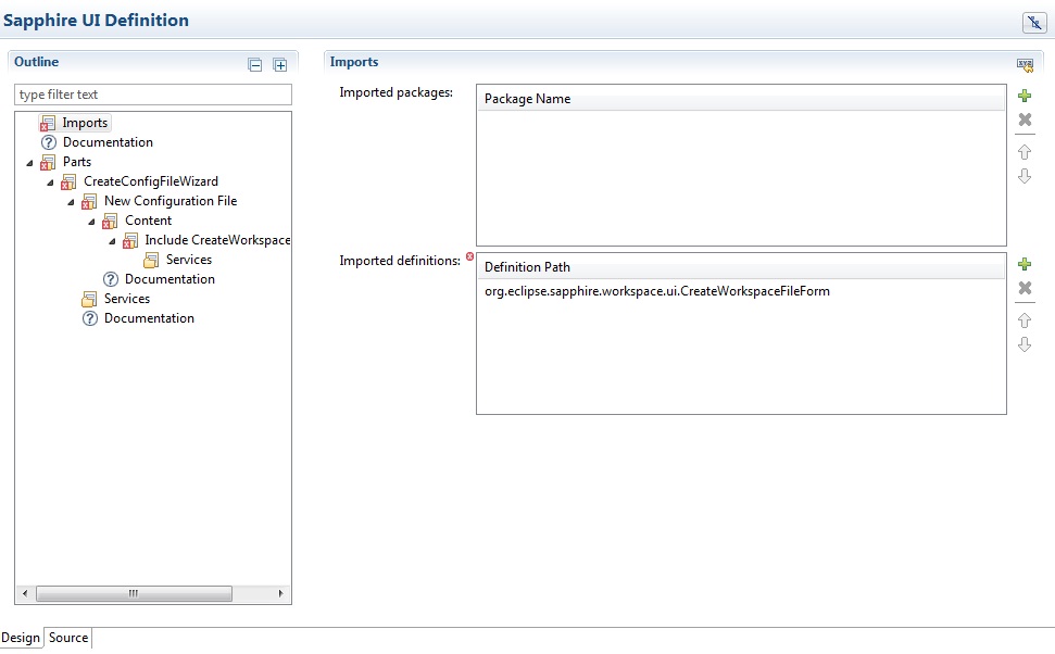

Re: Generating a config.xml file [message #1015533 is a reply to message #1015448] Fri, 01 March 2013 02:15 Go to previous messageGo to next message
index.php/fa/13622/0/
I checked the validity of the .sdef file as you suggested. I found that it is not able to resolve neither the class definition CreateWorkspaceFileWizard or the file CreateWorkspaceFileForm , the sdef file. Though i have the libraries in the plugin. Please find the attachment
Could not resolve definition path "org.eclipse.sapphire.workspace.ui.CreateWorkspaceFileForm".
And i have registered it in the plugin.xml file as this,

Re: Generating a config.xml file [message #1015712 is a reply to message #1015533] Fri, 01 March 2013 16:14 Go to previous messageGo to next message
Do you have org.eclipse.sapphire.workspace.ui bundle specified as required bundle in your manifest?
- Konstantin
Re: Generating a config.xml file [message #1015820 is a reply to message #1015712] Sun, 03 March 2013 02:54 Go to previous messageGo to next message
Yes i have it in my Manifest
Re: Generating a config.xml file [message #1016028 is a reply to message #1015820] Mon, 04 March 2013 11:12 Go to previous messageGo to next message
At this point, you will need to carefully compare your project with the samples project to find what is causing it not to work.
1. Compare all of the project metadata (including the files that start with '.' and all of the contents of the '.settings' folder). For instance, did you enable annotation processing for your project.
2. If #1 all checks out, is your wizard sdef located at "com/coutient/assetconfigfile/editor/CreateConfigFileWizard.sdef"?
- Konstantin

Re: Generating a config.xml file [message #1064182 is a reply to message #1010854] Tue, 18 June 2013 02:56 Go to previous messageGo to next message
Hey,
I have experienced the same even if I import the sample plugin as source project (0.6.2).
At runtime the wizard seems to work.
Thank you.
Kon
Re: Generating a config.xml file [message #1064314 is a reply to message #1064182] Tue, 18 June 2013 11:44 Go to previous messageGo to next message
Could you open a bug report? Please detail which Sapphire plugins you have imported in your workspace as a project. Is it just the samples project?
Re: Generating a config.xml file [message #1064419 is a reply to message #1064314] Wed, 19 June 2013 03:55 Go to previous messageGo to next message
I just imported the sample project into my workspace. I used Ctrl+Shift+T to check if the type does exists somewhere in the my target but it doesn't.
https://bugs.eclipse.org/bugs/show_bug.cgi?id=411086
Thank you!
Kon
Re: Generating a config.xml file [message #1064733 is a reply to message #1064419] Thu, 20 June 2013 13:05 Go to previous message
I fixed the reported issue in 0.7 release stream. Imported definitions are now correctly resolved by sdef editor.
