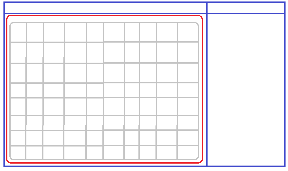

Found solution:
At first I had the following crosstab, drawn with blue, with a grid inside it, drawn with gray.
index.php/fa/20918/0/
In the XLSX file, the gray grid would be outputted as a single cell, with all grid elements merged into one text.
As Jim Talbut says here, this is caused by the fact that nested elemented are handled with a "one cell in = one cell out" rule, which overrides everything else.
So, my solution: I added another grid, marked with red, like so:
index.php/fa/20919/0/
So, just another grid with 1 row and 1 column, i.e., 1 cell. The outer red grid is treated with the "one cell in = one cell out" rule, and the inner gray grid is displayed correctly in the XLSX file.
Perhaps this will help someone else in the future. Cheers!
