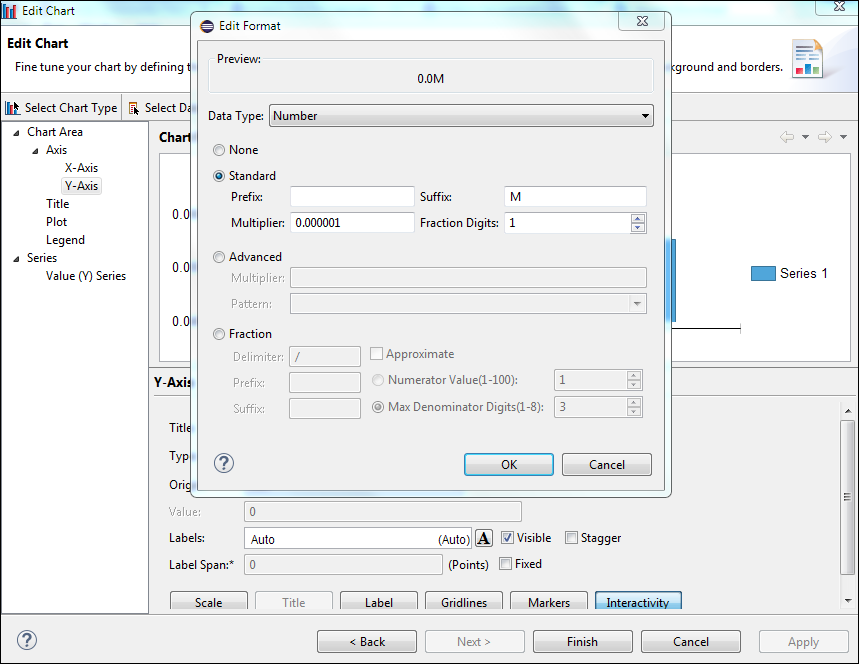

Re: Newbie - Reading in data basics [message #1626128 is a reply to message #1614541] Fri, 20 February 2015 16:04 Go to previous messageGo to next message
The easiest way to get your axis value to look how you want is to go into the chart editor, select the format chart tab, go to the y-axis section, and click on format. Here, you can set a multiple and a suffix to get your axis label to display in the format of #.#K or #.#M. See the attached image.

Re: Newbie - Reading in data basics [message #1630621 is a reply to message #1626128] Mon, 23 February 2015 04:40 Go to previous messageGo to next message
Thanks Michael, I'll give that a try today. As I've looked at it at the axis level before, I'm pretty sure I was putting for format in incorrectly; a BIRT World forum post seemed to indicated that "0.0," would be a valid format but it looks like the digit indicator has to be a # and not 0.
Re: Newbie - Reading in data basics [message #1630843 is a reply to message #1630621] Mon, 23 February 2015 07:32 Go to previous messageGo to next message
Sorted, thanks for your help Michael!
