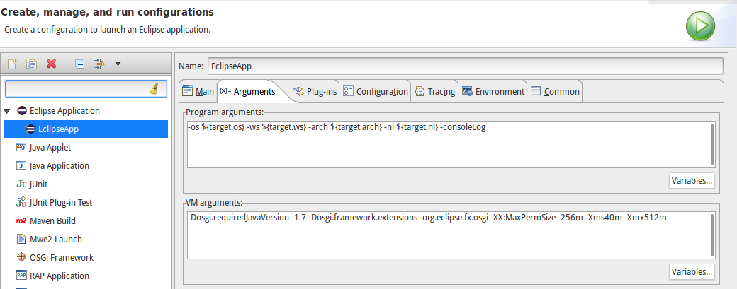

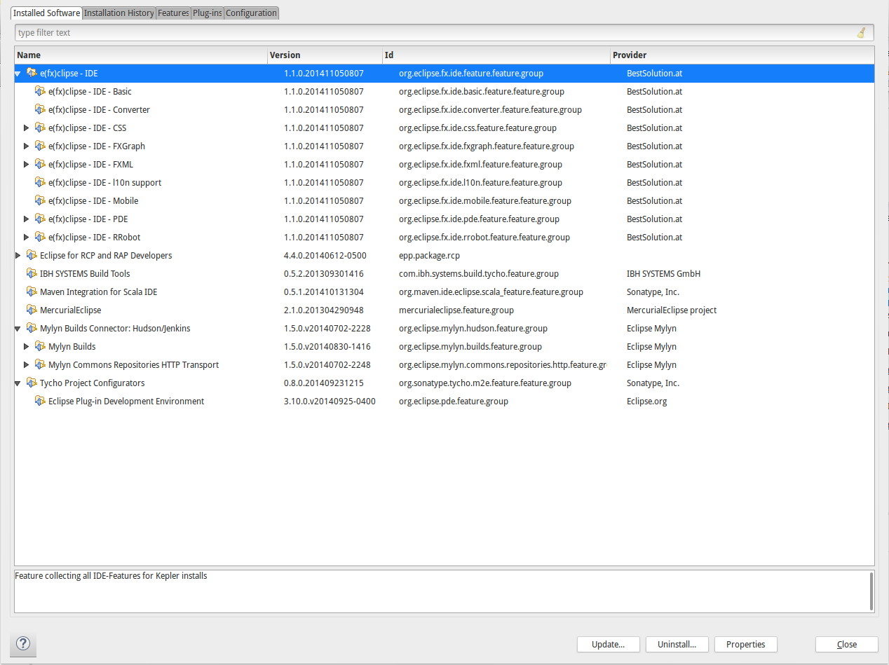

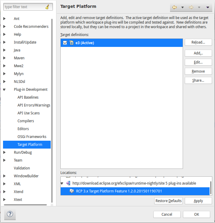

Q: I installed last version of RPC (Luna Release (4.4.0) Build id: 20140612-0600), configured my project (see details in attachments), and it doesn't work. Something tells me, that it is a software problem on my workstation. But i checking my configuration again and again and i really have no idea what is it. All errors are in attachment file ("stack trace.551").
Info:
JavaFX was installed by maven.
(mvn com.zenjava:javafx-maven-plugin:2.0:fix-classpath)
[Sys params]
java version "1.7.0_71"
Java(TM) SE Runtime Environment (build 1.7.0_71-b14)
Java HotSpot(TM) 64-Bit Server VM (build 24.71-b01, mixed mode)
index.php/fa/20501/0/
index.php/fa/20502/0/
index.php/fa/20503/0/

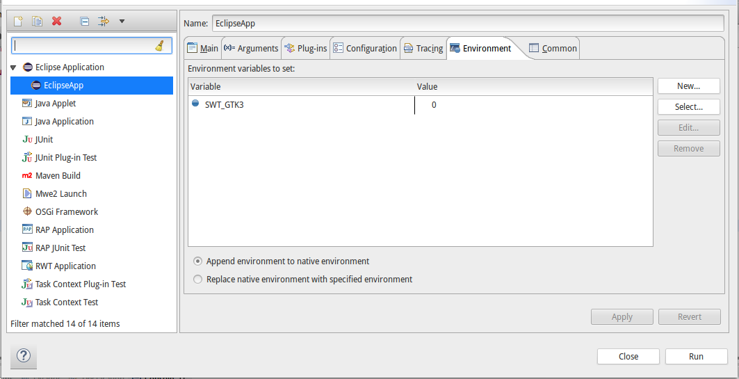

Oh, Tom, great thanks for help.
After set param SWT_GTK3=0 in the launcher environment, everything work fine again.
index.php/fa/20522/0/
