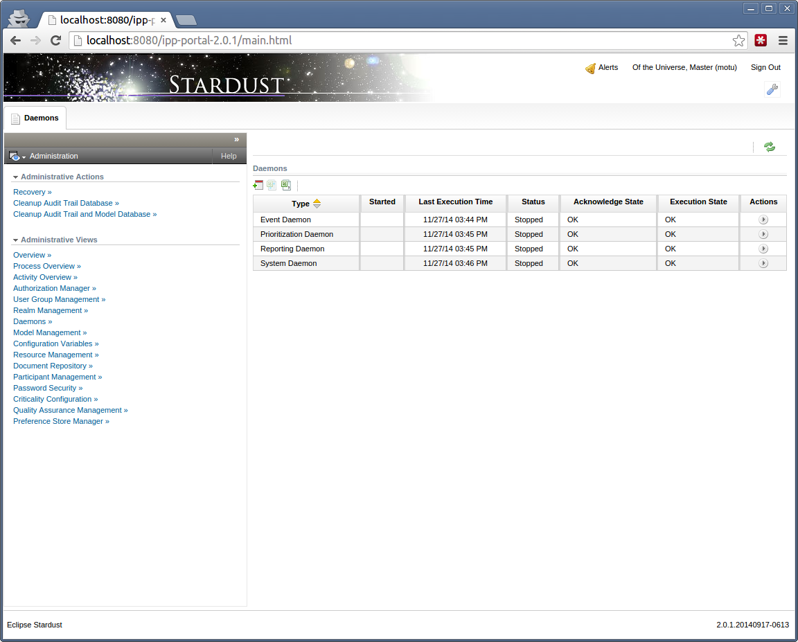

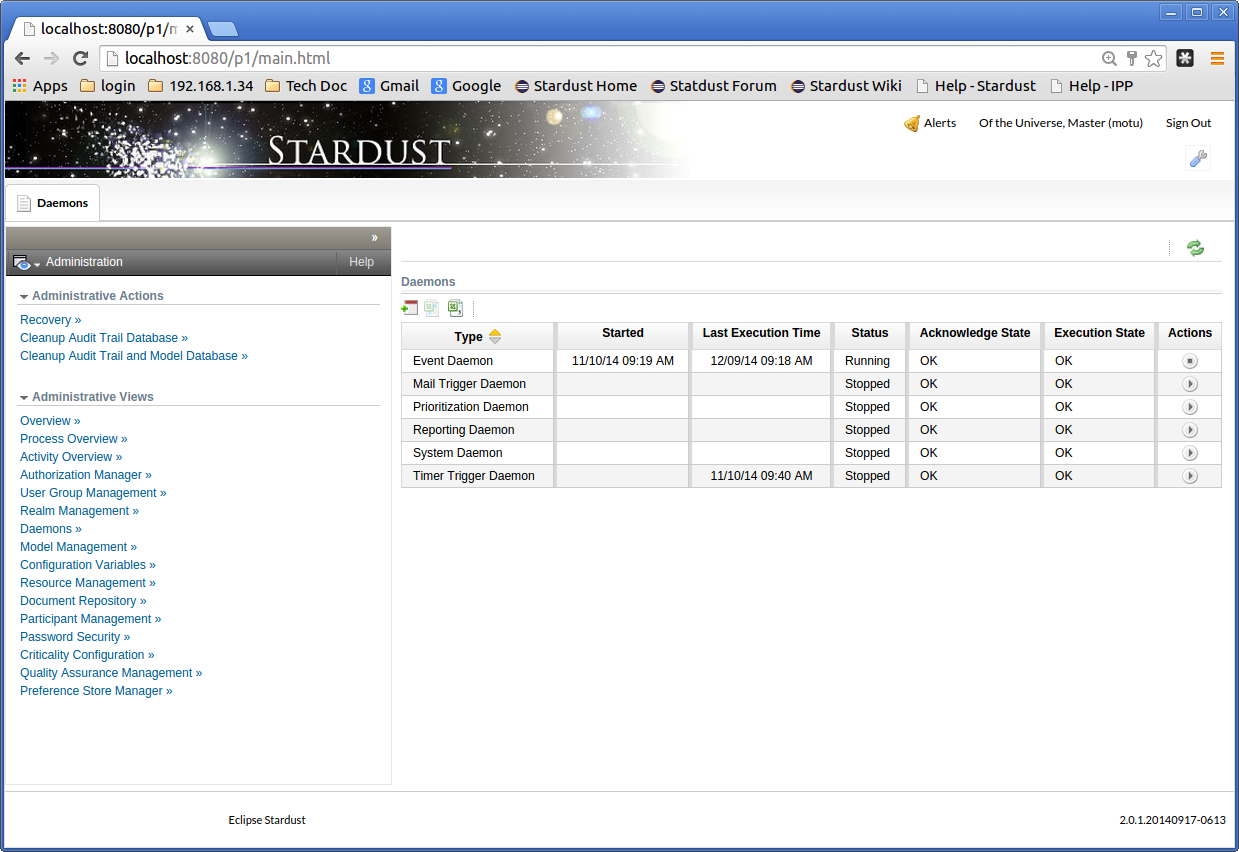

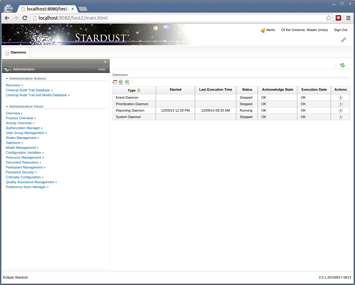

I created 2 stardust portals (v2.0.1) from the eclipse update site on separate computers (dev1 and dev2).
I noticed that on dev1 machine, I do not have the mail trigger and timer trigger daemons while on the dev2 machine I have both listed on the daemon management page.
I have tried building the portal using the maven archetype but the 2 daemons are missing as well.
Any ideas why I have 2 additional daemons on dev2 portal?

Mail Trigger and Timer Trigger daemons are created only if you have used them in any of the deployed model. So in your case model deployed in DEV2 machine must be using these daemons.
