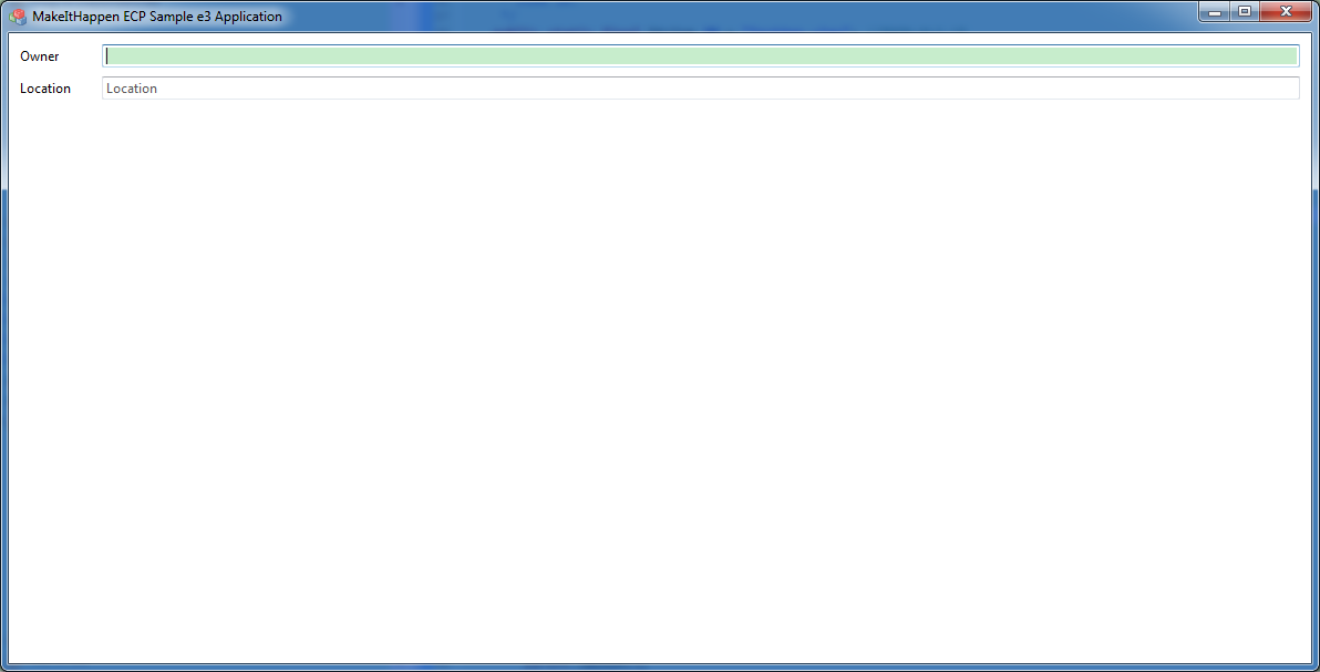

Ok , you can see the following code.
First, I can get a EClass dynamically
public static EClass getEClass() {
		 * Instantiate EcoreFactory

Then I use the returned EClass to get a UI component by EMF Forms.
EObject dummObject = EcoreUtil.create(bookStoreEClass);
			final ViewModelContext vmc = ViewModelContextFactory.INSTANCE.createViewModelContext(
				ViewProviderHelper.getView(dummyObject, null), dummyObject, new DefaultReferenceService());
			render = ECPSWTViewRenderer.INSTANCE.render(content, vmc);

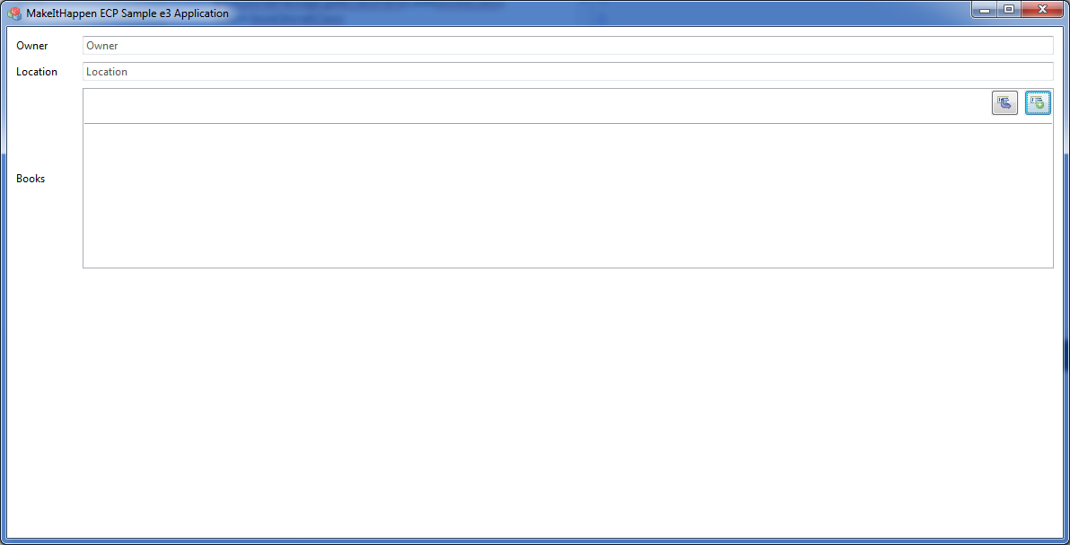

The generated UI component should contain three kind of controls for three feature of bookstore, but it only contains two (owner and location, but not books), you can see screenshot (result.png), but the expected result should be like expected.png.

Re: [EMF Forms]Reference feature is not supported when using Dynamic EMF [message #1489395 is a reply to message #1489186] Thu, 27 November 2014 05:28 Go to previous message
the property type of containment references is by default "None". In
static EMF, this is set in the gen model. It has to be editable to be
shown in the UI.
