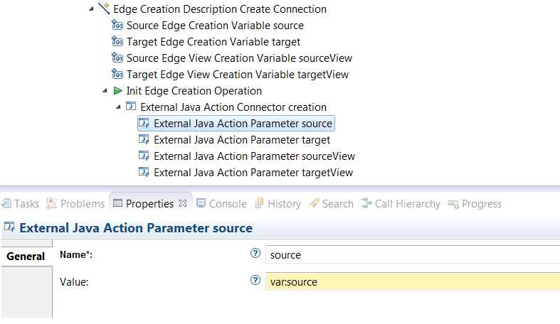

In my "odesign" file, I defined a very basic item : an Edge Creation Description with an External Java Action as operation. This External Java Action takes all available variables (source, target, sourceView, targetView) as parameters (see "odesign.png" attachment).
index.php/fa/19963/0/

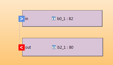

It works well. The java action well receives parameters and I am able to compute my links which appear in my diagram (see "diagram.png" attachment)
index.php/fa/19962/0/

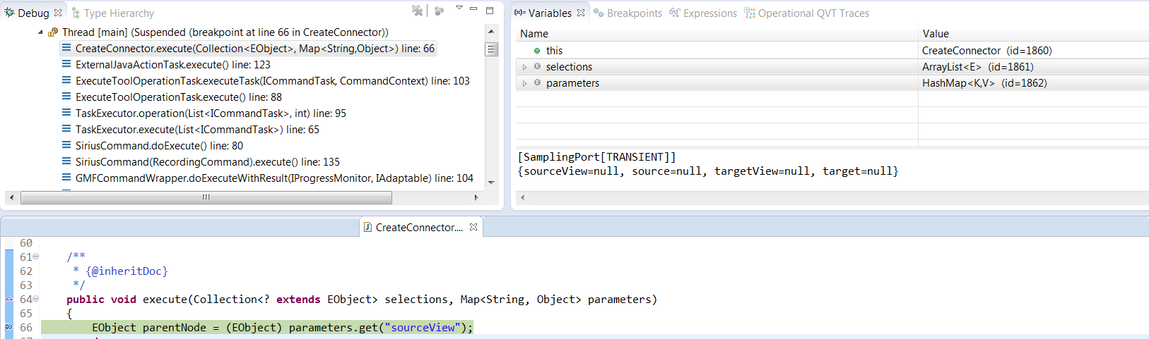

The problem is that, sometimes (about 1/10 times), when i drop the connection, the java operation is well called, the "selections" parameter of my operation is well set to the target BUT all parameters are equals to null (see "parameters.png" attachment).
index.php/fa/19964/0/
(So, i'm not able to compute the links....)

It is hard to reproduce with a simple case but it's done, we found the answer !
You have to know that in our tool, we merged EMF resources :
- in our tool, we have only on resource set that contains each project resource.
- we reproduced this structure inside Sirius... only one resource set... the same than in the heart of our tool.
- so in our Sirius diagram, we are able to import items from other project (initially, different resources in Sirius)
And that is the origin of our bug !
When i created my link in Sirius, the used Sirius Interpreter was sometimes the wrong one.
Sirius sometimes used the Interpreter associated to the original resource, not the merged one !
So, to correct it, we merged Sirius Interpreters !
Thank you for your help,
