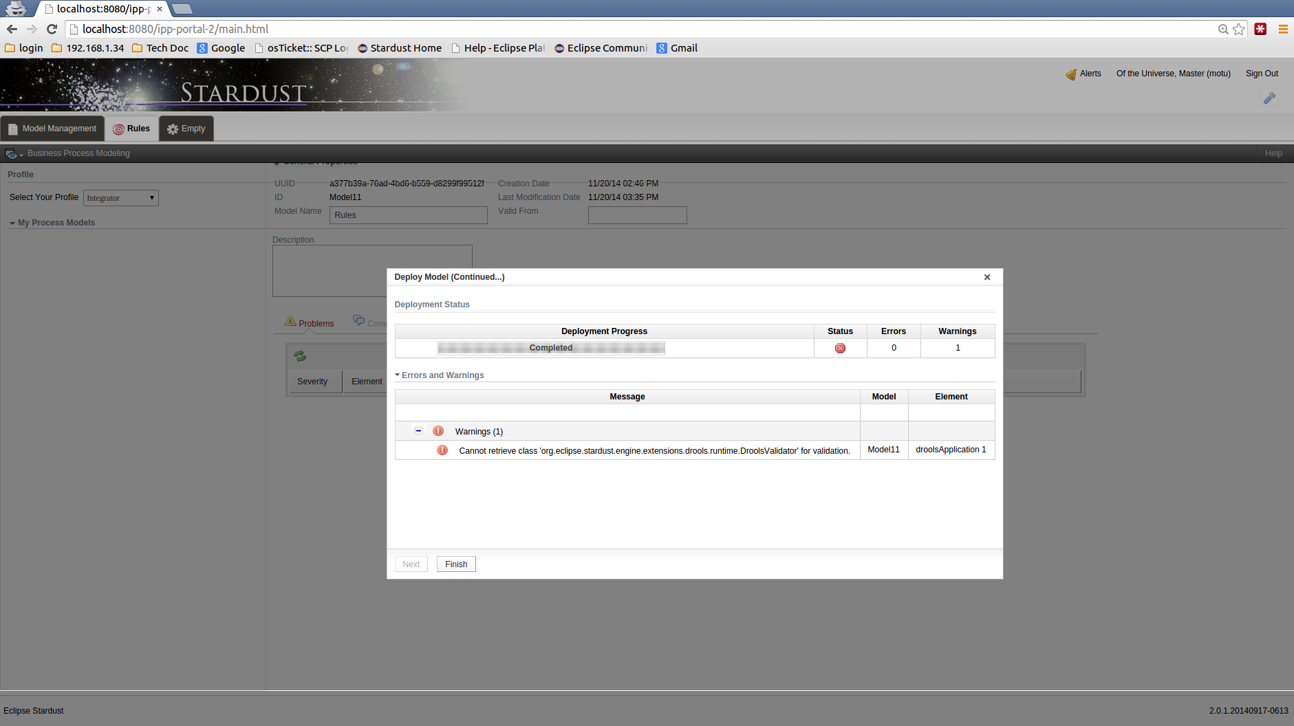

In Business Process Modelling I included a Rule task in a model.
When I try to deploy the model I get the warning:
Cannot retrieve class 'org.eclipse.stardust.engine.extensions.drools.runtime.DroolsValidator' for validation.

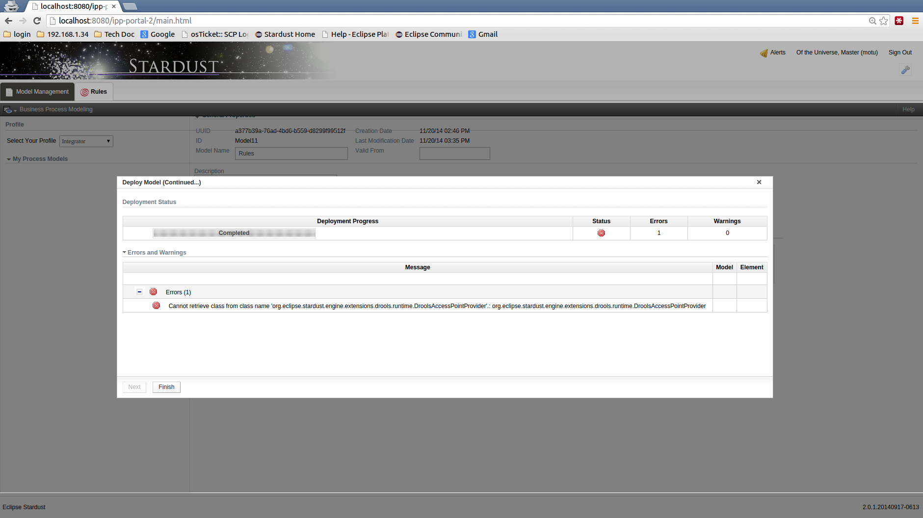

If I select Ignore Warnings check box when I deploy the model I get the error:
Cannot retrieve class from class name 'org.eclipse.stardust.engine.extensions.drools.runtime.DroolsAccessPointProvider'.: org.eclipse.stardust.engine.extensions.drools.runtime.DroolsAccessPointProvider
