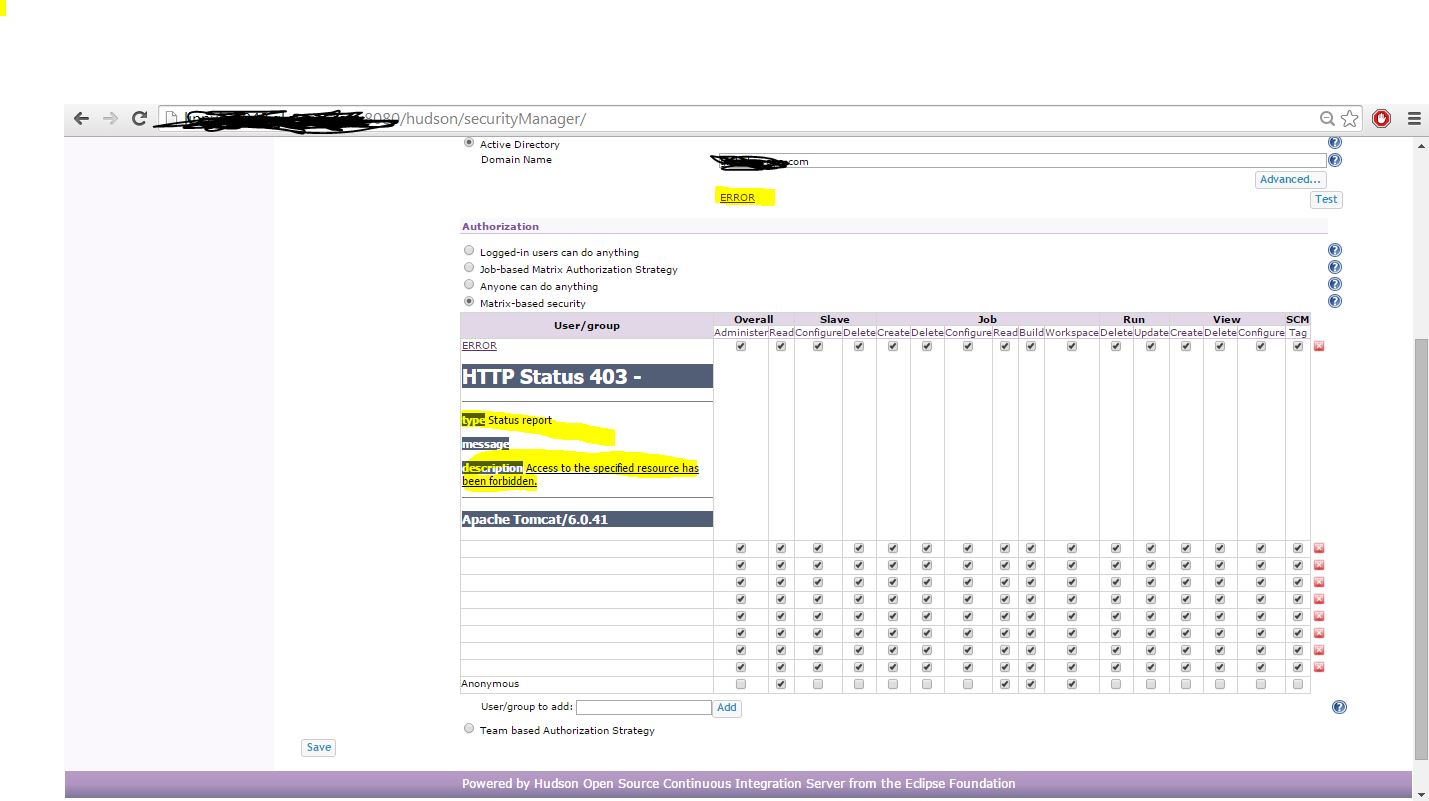

Re: Hudson support [message #1647353 is a reply to message #1548400] Tue, 03 March 2015 06:34 Go to previous message
Hi Prakash,
currently i am using Hudson 3.2.1 can you please tell me minimum versions of jdk,ant,maven and apache-tomcat ?
coming to my problem am using Active Directory plugin 1.31-h3 matrix based Authentication, when i am trying to add user to matrx based authentication it is showing error.

i have edited hudson-security.xml file to add users in backend thats why it shows no of users in attached sreenshot.
Thanks in Advance Smile
