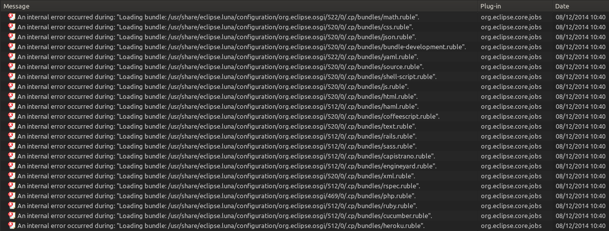

Regarding the Error Log, nothing is reported when I change this setting in the Preferences menu, nor when I close Eclipse, but when it starts up there numerous errors reported on Ruby bundles. I doubt it has anything to do with the current line colour, but I am attaching an image in any case.
Thank you.
Re: Luna: how to permanently change the current line highlight? [message #1503481 is a reply to message #1503261] Mon, 08 December 2014 09:02 Go to previous messageGo to next message
Sounds like that workspace is messed up. Try with a new, clean workspace and see if it behaves correctly.
