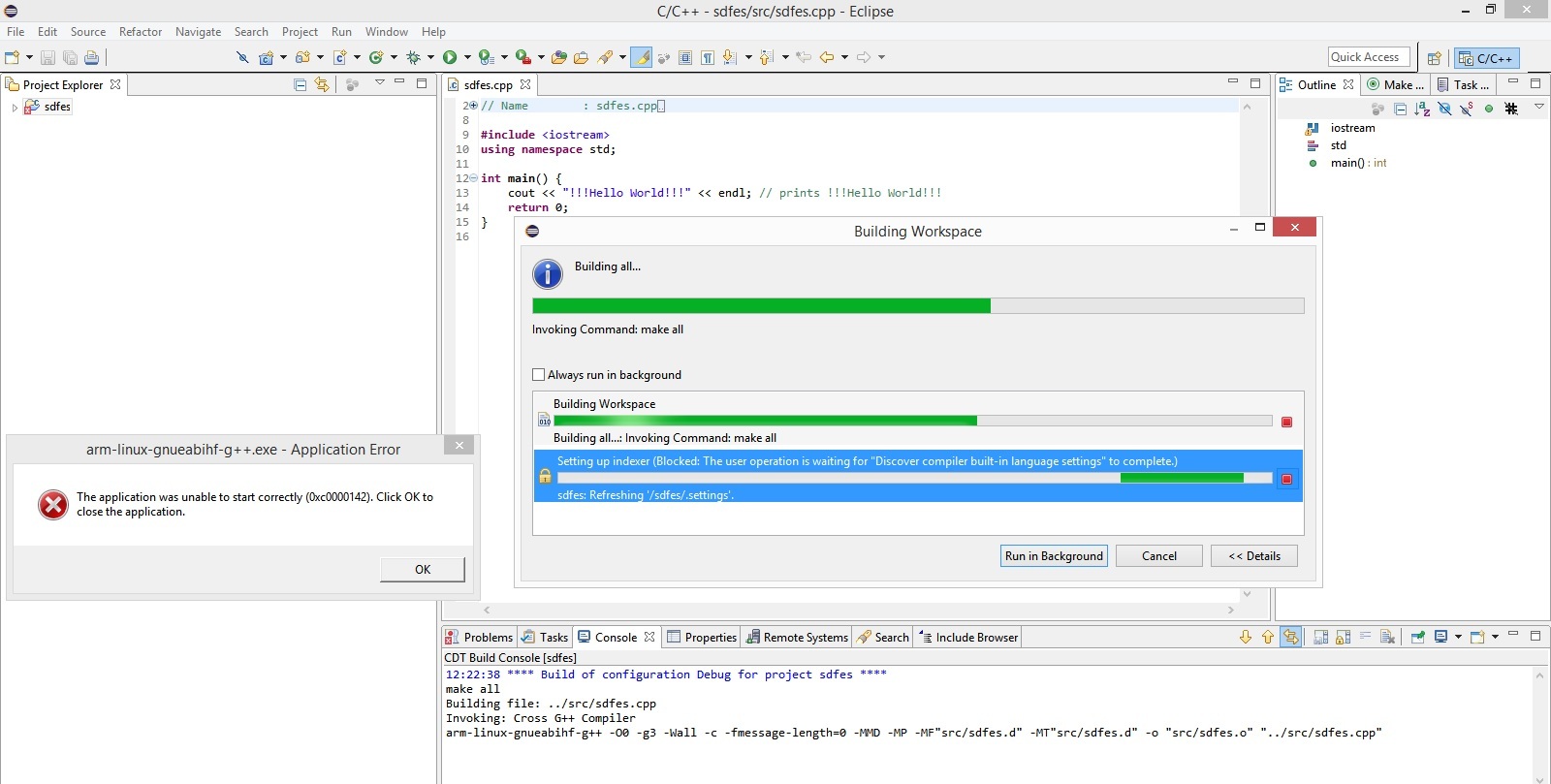

Eclipse errors are ;
make all
Building file: ../src/sdfes.cpp
Invoking: Cross G++ Compiler
arm-linux-gnueabihf-g++ -O0 -g3 -Wall -c -fmessage-length=0 -MMD -MP -MF"src/sdfes.d" -MT"src/sdfes.d" -o "src/sdfes.o" "../src/sdfes.cpp"
make: *** [src/sdfes.o] Error -1073741502
or if i do partial compile in prompt;
make all
Building target: sdfes
Invoking: Cross G++ Linker
arm-linux-gnueabihf-g++ -o "sdfes" ./src/sdfes.o
make: *** [sdfes] Error -1073741502
