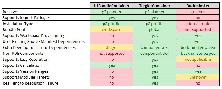

Some time ago I prepared this small feature matrix:<br>
<br>
<img src="https://www.eclipse.org/forums/index.php?t=getfile&amp;id=19177" alt=""><br>
<br>
where IUBundleContainer := PDE target definitions. I hope this helps
;-)<br>
