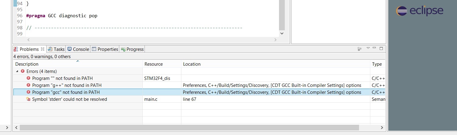

HElp me! resolve this error!
The GNU arm tool chain has been added properly!
I did refer to various blogs and posts on this forum and am still left without a solution.
I kindly request the community to help me resolve this issue.
It would be of great help if i was provided with a step by step solution.
  • Attachment: Error.jpg
    (Size: 119.98KB, Downloaded 34938 times)

Eclipse uses the compiler to get the builtin include paths and symbols. The default command is "gcc". You have to adapt it to your compiler.
More info can be found here:
https://wiki.eclipse.org/CDT/User/FAQ#I_am_using_a_non_gnu_compiler_and_I_get_the_following_messages:_.22Error_launching_external_scanner_info_generator_.28gcc_-E_-P_-v_-dD.22_and_.22File_not_indexed_because_it_was_not_built_.22._How_do_I_get_rid_of_them.3F
http://help.eclipse.org/luna/index.jsp?topic=%2Forg.eclipse.cdt.doc.user%2Fconcepts%2Fcdt_c_scanner_discovery.htm

1) Make sure that you have a path to your GNU in your system variables.
To check it, go to Computer Properties > Advances System Settings > Environmental variables > in "User variables" you should get a "PATH" variable. Edit it, and check if there's a path to your GNU. If not, add it.
2) Go to Eclipse, Window > Properties > C/C++ > Build > Environment and check if you have a PATH variable there. It should have value of "${PATH} (which directs to your just set system variable) or just a path to your GNU. For me, setting it to the "${PATH}" value worked. Tick "Appendvariables to native environment" below.
3) Now go to Properties > C/C++ > Build > Settings > Discovery and find settings for your GNU (e.g. "CDT GCC Built-In Compiler Settings MinGW" as for me). To the compiler specs below the list add two paths. First to "gcc.exe" file in your GNU directory (e.g "C:\MinGW\bin\gcc.exe" for MinGW), second - to "g++.exe" in the same dir.
4) Apply all changes and it should work now.
However the errors still appear for me, but at least code gets started and works Wink
