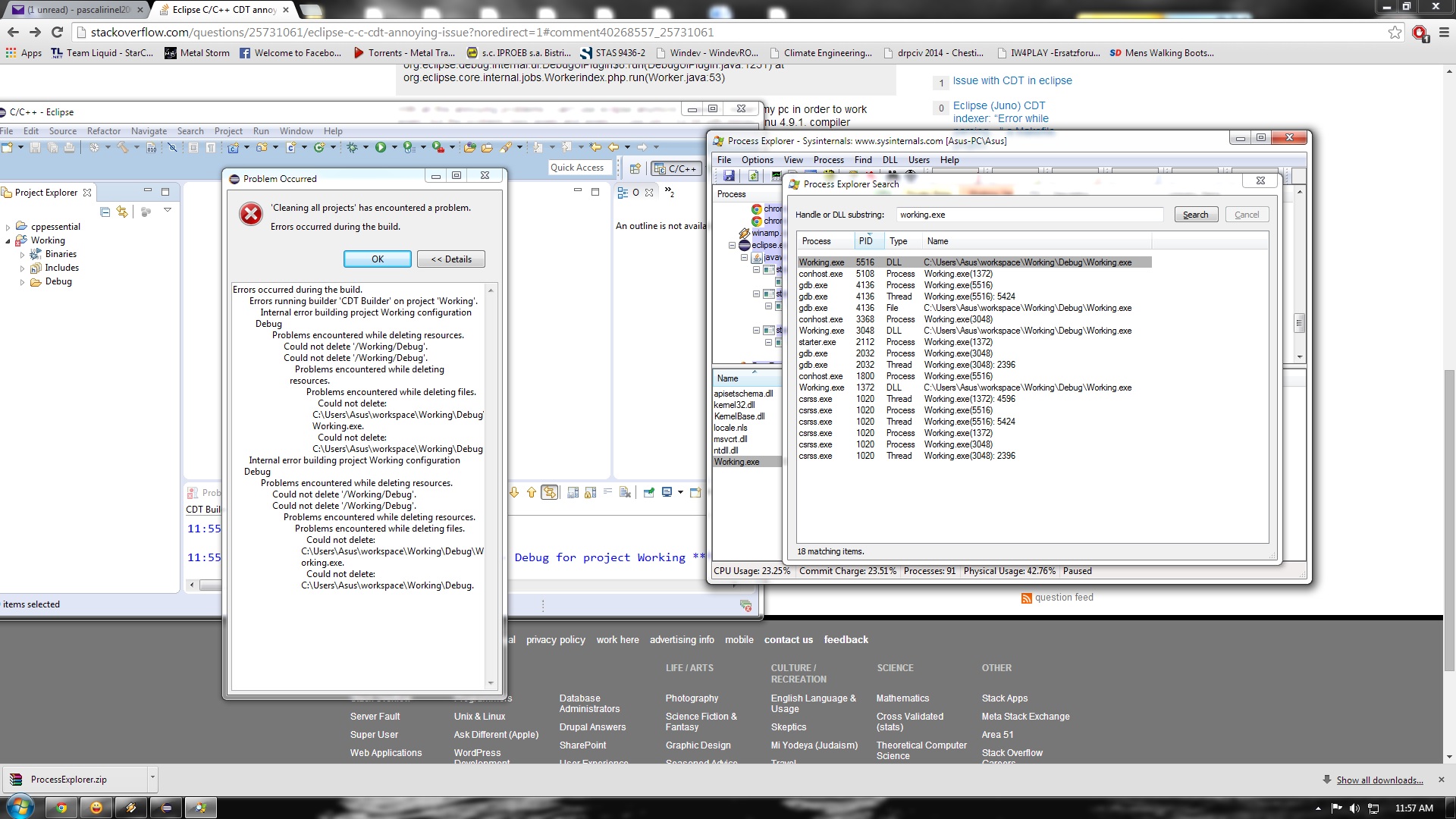

I am having this problems regarding eclipse...
I have this problem day by day and cannot figure it out...
When i clean all projects it says ... well, I will leave a photo for you to see.
This issue won't let me work in eclipse anymore...i need to restart my pc in order to work again, but this problem risees again and again ; sometimes when i clean all projects it cleans it , but the most of the time it won't do ...
I have opened process explorer thinking it my help.
Thanks !

Re: In love with eclipse (c/c++) but...it won't work [message #1420741 is a reply to message #1420649] Wed, 10 September 2014 07:55 Go to previous messageGo to next message
Since your program is running the OS will not allow the deletion/clean of your executable,
So the program needs to be stopped before you clean the project.
Re: In love with eclipse (c/c++) but...it won't work [message #1420839 is a reply to message #1420741] Wed, 10 September 2014 10:59 Go to previous messageGo to next message
Alvaro Sanchez-Leon wrote on Wed, 10 September 2014 11:55
what OS ? operating system !? do you refer to Process Explorer ?
If I am not wrong please understand that process explorer was opened after that annoying message from eclipse...
[Updated on: Wed, 10 September 2014 11:08] by Moderator
Re: In love with eclipse (c/c++) but...it won't work [message #1420940 is a reply to message #1420839] Wed, 10 September 2014 14:09 Go to previous messageGo to next message
you are running your application over the Windows OS.
Re: In love with eclipse (c/c++) but...it won't work [message #1420954 is a reply to message #1420649] Wed, 10 September 2014 14:37 Go to previous messageGo to next message
what does OS mean; what is OS ? be more specific please.
Re: In love with eclipse (c/c++) but...it won't work [message #1421151 is a reply to message #1420954] Wed, 10 September 2014 21:49 Go to previous messageGo to next message
Your program is under execution on the Windows Operating System (OS), and therefore this Windows OS does not seem to allow the removal of your exe file.
I tried on the Linux OS and this behaves different as I can remove the executable file while the program is actually running.
You can try stopping your program before cleaning the project.
Re: In love with eclipse (c/c++) but...it won't work [message #1421264 is a reply to message #1421151] Thu, 11 September 2014 02:11 Go to previous messageGo to next message
you mean kill the process, no ? killing working.exe ?
Re: In love with eclipse (c/c++) but...it won't work [message #1426420 is a reply to message #1421264] Thu, 18 September 2014 14:29 Go to previous message
As long as your application "working.exe" is running the file (and the folder containing it) cannot be deleted. You have to stop "working.exe" before cleaning your project.
