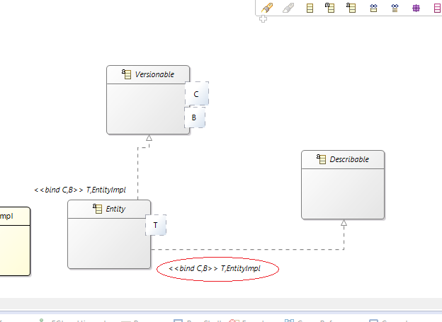

i have two interfaces, one interface with ETypeParameters and one without it.
When I create the superType relation to both interfaces the name is duplicated.
In my case, Describable interface has not ETypeParameter but in its relation appears the "bind" tag.
How to avoid this?
best regards!

It is indeed a bug, could you raise it please, if possible with a simple modeling project highlighing the problem ?
