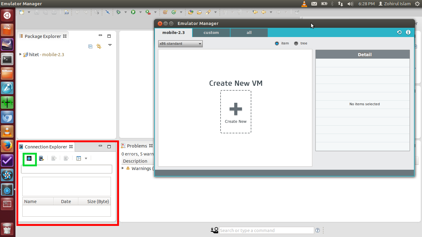

I want to record a process of emulator launching from emulator manager [connection explorer->emulator manager->create emulator->launch emulator]. But objects from emulator manager window are not captured by rcptt. Is there any solution?

What is "emulator manager window"? Is it a part of Eclipse-based application?
Could you please attach screenshot with that window when emulator manager is running as AUT?

Thanks for your early response.
Yes, "emulator manager window" is a part of Eclipse-based application to develop Tizen apps.
I have attached a screenshot. From "connection explorer" [red marked tab] you can click green marked button to open "emulator manager" window.

Thank you for the screenshot.
Could you please provide me with some additional details.
What steps reproduce this issue?
Did you try to do following steps?
  1. start recording ECL script
  2. open emulator manager window
  3. switch to assertion mode in ECL
  4. try to assert some object in the window
What was the result? Does any error appear?
Can you send me your AUT to reproduce this issue local?
