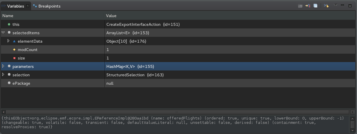

I'm trying to pass all the items I have selected in my diagram editor to a java action (IExternalJavaAction), but the execute method of the action only gets one single element in its first argument.

3) If I call a Java action the collection of selected items given to the execute method only contains 1 element.
index.php/fa/18857/0/
4) I also tried to pass [thisEObject/] as a parameter to the method. If I execute the action there is only 1 element in the value of the corresponding HashMapEntry.
index.php/fa/18858/0/

Indeed seeing the Sirius code, this can occurs and is a bug. Could
you raise a bugzilla with your scenario and the needed data
to reproduce. The odesign in attachement is not enough as it is an
extension of another odesign, could you provide a sample project, with
..ecore, .odesign and .aird?

thank you for your reply. I've reproduced the bug using another more simple project and attached it to the bug-report at https://bugs.eclipse.org/bugs/show_bug.cgi?id=441618.

I confirm the bug.
