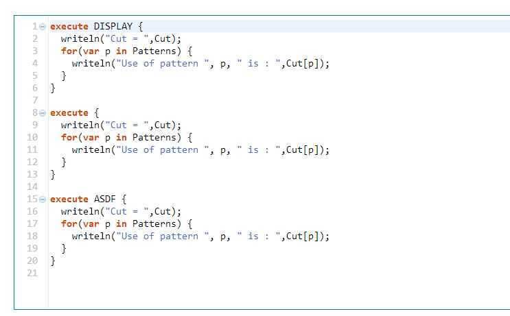

I don't understand the problem, I've changed the example to include
three 'execute's and they each style their contained javascript
(screenshot attached). I assume I'm trying the wrong thing.
If your previously-attached screenshot shows the problem then can you
specify which text in it is not styled as you need?
Grant

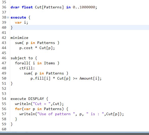

Thanks for your answer.
The issue is that so-called execute blocks can be mixed with normal grammar statements, as in :
execute {
var i;
dvar int foo;
execute BLOCK {
var j;
execute keywords are part of the normal grammar, and should be colored in blue, along with dvar. And contents enclosed in execute block should be in other color.
So far I anderstand that the rule for detecting the first execute block matches until the end of the second block, and I would like it to stop at first matching }, so that dvar is colored in blue.

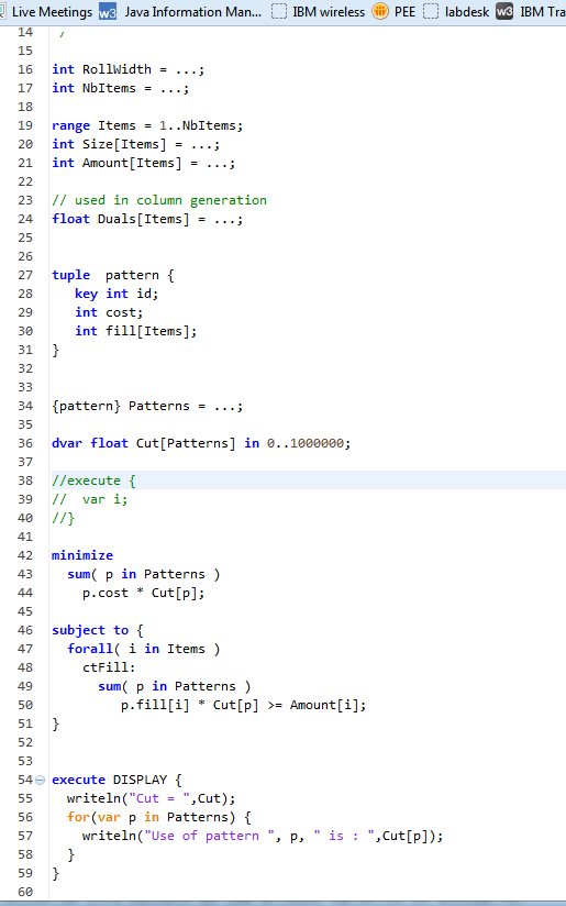

Ok, I understand what you're saying. I think the partitioning of the
code blocks is actually working fine, but the problem is that the same
visual styling is being applied to the js keywords and to your
language's keywords. To test this, in your syntax.js change the two
"name" values from "keyword.mod" to "string", and you should see the
styling for your language's keywords become distinct from the js keywords.
Assuming you see this, you probably need to define a .css style for
..keyword.mod rather than for .keyword, to ensure that it is the style
that gets applied to your language's keywords rather than Orion's
definition for .keyword.
If you don't think this is the issue you're seeing or if you have
further questions then please let me know.
Grant
Re: Grammar for complex language [message #1415356 is a reply to message #1415348] Tue, 02 September 2014 11:36 Go to previous messageGo to next message
I think the issue is that the first execute block is correctly recognized, but it is extending beyond line 40, where is should switch back to normal coloring. Now it is extending until line 59 because matching rule finds } at this location.
Everything in between is considered as Javascript.

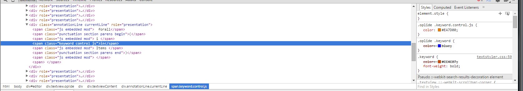

I'm not sure what to think here, I don't see this problem. My context
is a bit different from yours, but I would not think that this could
affect the styler's identification of block bounds. Can you use the
element inspector in the Chrome debugger to hover over one of the
incorrectly-coloured "in"s and verify whether its class is .keyword.mod
or .keyword.control.js? And which Orion and browser versions are you using?
Grant

Here is the inspector view in Chrome. The badly colored in keyword has the .keyword.control.js style.
I think the version I use is 6.x, is there's a way to know the version from .js sources ?
I am only using the editor JS component, not the complete framework.
