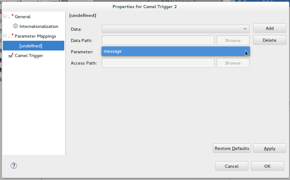

Re: Camel Trigger, email and headers [message #1405761 is a reply to message #1404504] Fri, 08 August 2014 01:50 Go to previous messageGo to next message
index.php/fa/18827/0/
Screenshot of camel configuration - only drop-down is available
Where would I add additional parameters?
Kurt
Re: Camel Trigger, email and headers [message #1410602 is a reply to message #1405761] Thu, 21 August 2014 03:08 Go to previous message
Kurt,
To see additional parameters you would have to use the browser modeler. The Eclipse modeler only shows the single "message" parameter. If you would like to continue using the Eclipse modeler, you can check out the following article https://wiki.eclipse.org/Stardust/Knowledge_Base/Integration/Camel/Email_Trigger_with_Process_Attachments and adapt it for use with a Stardust Camel Trigger.
-Srini
