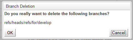

Re: push a commit to gerrit. [message #1397068 is a reply to message #1396804] Wed, 09 July 2014 02:42 Go to previous messageGo to next message
Thanks for your feedback.
In the Eclipse Scout project, we follow a git-flow like branching policy and we commit on the develop branch instead of master. I do not think that this is a reason why it does not work.
With your input, I was able to find where my commit went: orion created a "refs/for/develop" branch.
In the Gerrit admin I also see this branch and I can delete it.
index.php/fa/18505/0/
I have have tried to enter "/refs/for/develop" (with the leading slash). I got this error:
index.php/fa/18506/0/
Why does Orion add a "refs/heads/" prefix?
