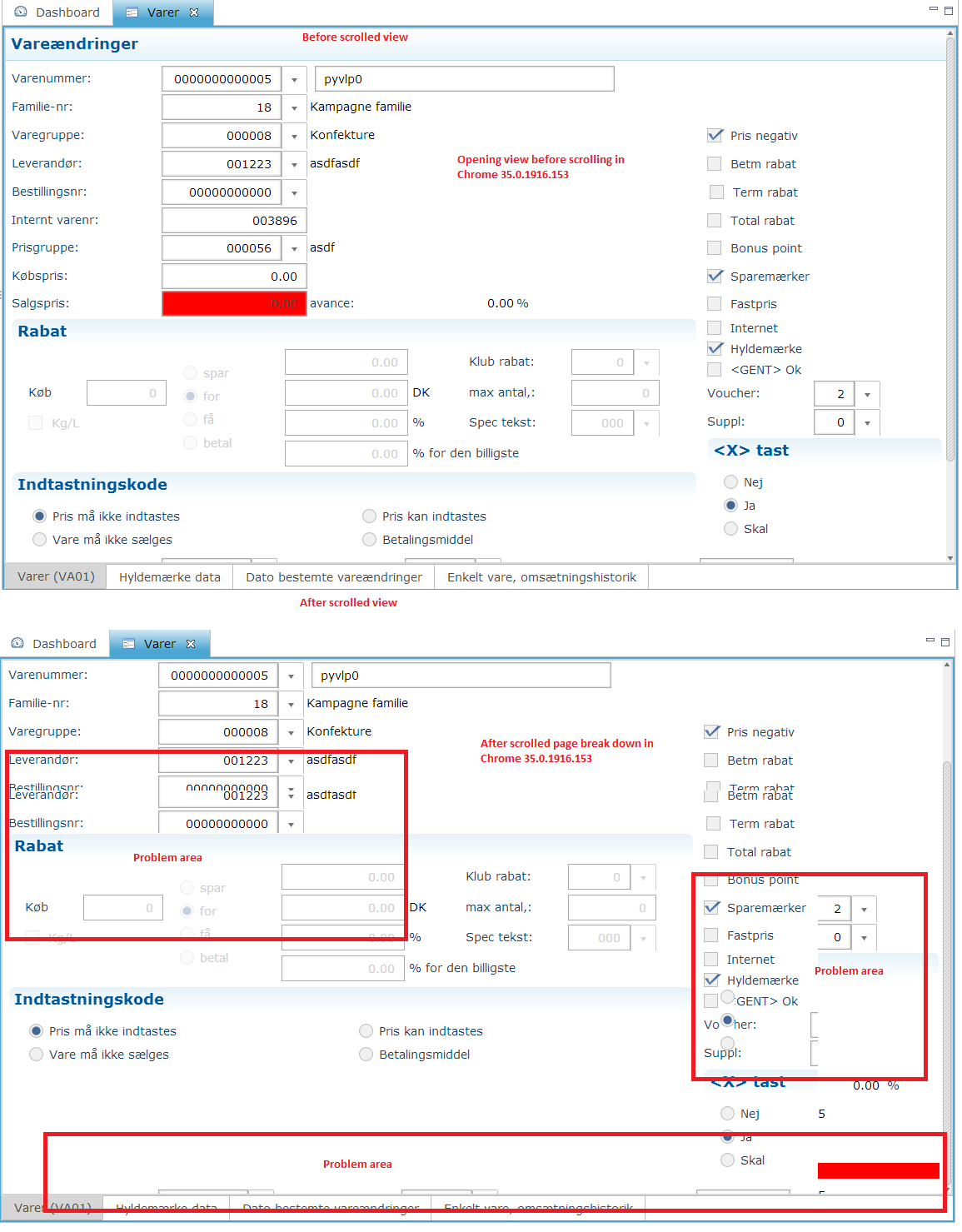

Recently I'm facing a problem when browsing a view content in Chrome Version 35.0.1916.153. In my application I've used ScrolledComposite. On this composite I've created some sections by using Section. My application supports single sourcing, I mean it runs on both RCP & RAP 2.2. In RCP, there is no problem. On the other hand, in RAP though contents are showing properly in FF, IE, Safari but in Chrome Version 35.0.1916.153 not. In Chrome for first time when scroll view comes it shows ok. When trying to scroll down or up some section doesn't move or some part scrolled with overlapping with other portion. Not whole page is scrolling.
I found it was not happening in earlier version of Chrome 35+. Though there was an another problem (Widgets disappearing in Google Chrome, Safari or Opera ) which was fixed by adding a javascript code. However, that code is removed for Chrome 35+ but this new scroll problem is occurred. Even I've tested in RAP 2.3 the scroll problem is still there. For better understanding please see the attachment.
Can any body help me how can I fix this problem or is it a known issue?
  • Attachment: example.png
    (Size: 116.27KB, Downloaded 113 times)
