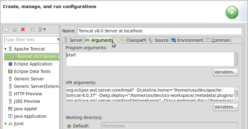

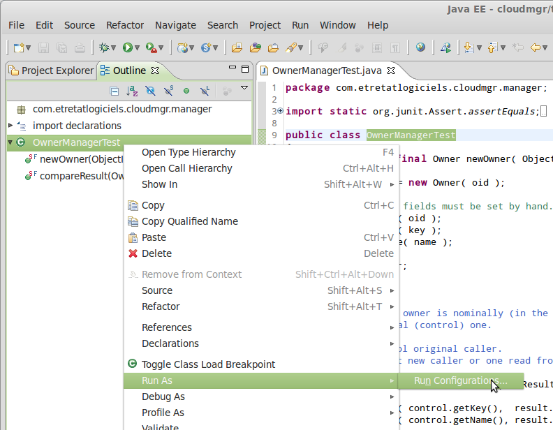

See attached. Does this help?
Re: Missing Arguments Tab? [message #1385988 is a reply to message #1385879] Thu, 12 June 2014 12:47 Go to previous message
Perfect, that did the trick! Thanks tons!!!!!
Russell, the screen shots were perfect.
