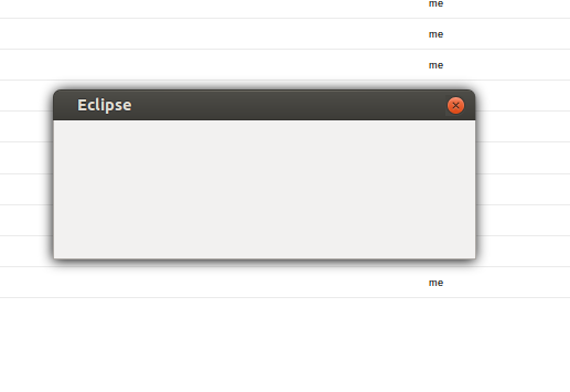

After I updated my Ubuntu 13.04, Eclipse stopped working.
Steps:
1) Eclipse properly working (but for a "Decoration calculation" error that sometimes appears)
2) I made a software update
3) now Eclipse does not start; after a few seconds a blank little window appear without any text in it
System: Ubuntu 13.04
eclipse.buildId = 4.3.0.I20130605-2000
I attached the log and a snapshot of the window that appears after the initial Eclipse window.

Sergio, the log shows "org.eclipse.swt.SWTException: Invalid thread access" from a stack that includes com.android.ide.eclipse.adt.AdtPlugin.start(AdtPlugin.java:218).
