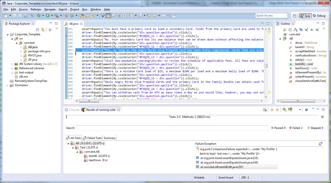

I'm running a TestNG test and the same test intermittently failing for the same web page from run to run. There is no fault on the web page and the test is failing randomly with consecutive runs at "assertEquals" method and complains that there is extra space in the string on the page that being tested.
Not sure if this is a bug related to latest release or a known issue.

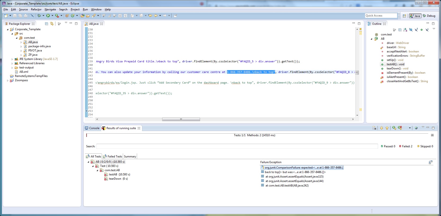

I've attached the screenshots of failing case where you can see test is failing at line #242 and at next run it fails at line #245 which means it passed at #242.
The test is derived from exporting from Selenium and it is passing in Selenium and failing only when running in Eclipse.
It seems that text is either compared differently or the web page is read differently in Eclipse compared with Selenium.
To summarize, the only functions of the assertEquals that fail are getText() and getAttribute(). But not all those function calls are failing in the project.
Most of them always pass but only few failing inconsistently.
