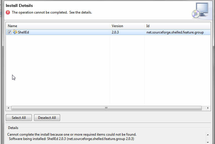

Thank you very much. For some reason I thought 'ShellEd' was an OS level install. But it is not it is a Ecliplse level install. I am not getting errors about missing parts. (See attached) Would you have any idea what is missing? The message lacks detail.

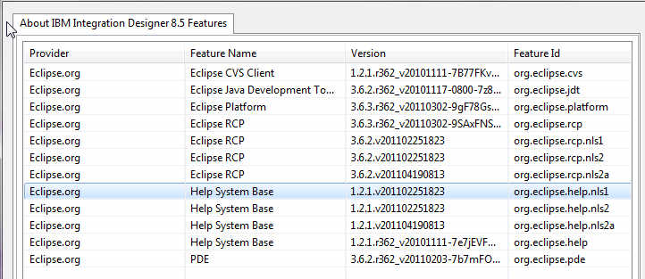

forget it I see the issue. I am on eclipse version 3.6 "ShellEd" needs 4.2 or 4.3. I will have to look and see if there is a version of "ShellEd" for eclipse 3.6 since I can not update the eclipse version because it is bundled with another IBM product.
