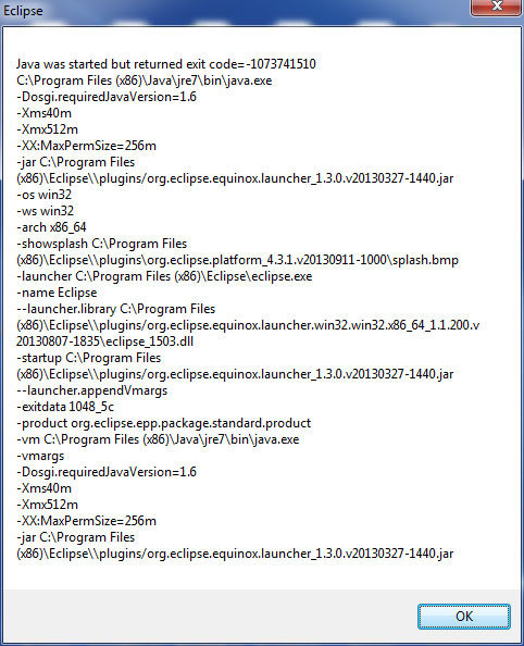

Thanks I added the correct path and now eclipse.exe will run but it returns an error code 107374150 as per the attached image that I saved here

You appear to be trying to run a 64 bit Eclipse on a 32 bit JVM. You
need to switch one of them. Both Eclipse and the JVM need to be the
same bit size.
Re: installation can't find JRE [message #1242017 is a reply to message #1241992] Sat, 08 February 2014 17:53 Go to previous message
wow, can't believe I missed that. Smile I will uninstall and find the 64 bit version and get back to you.
